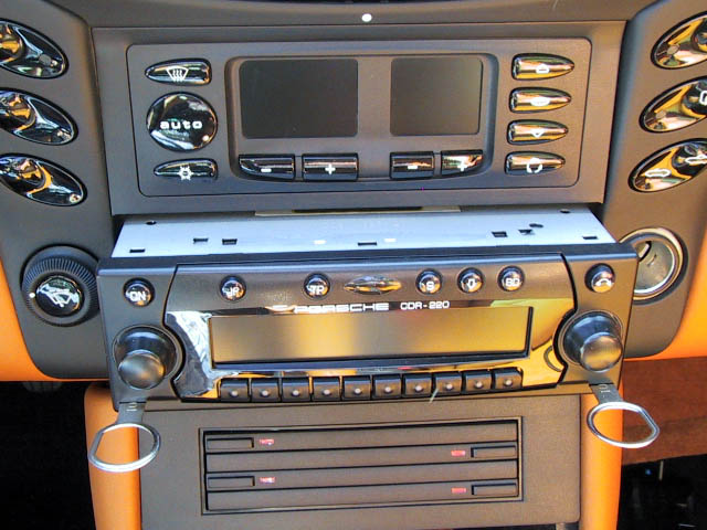

I am ready to put my interior back in the car with the new speakers but I do not have the reomte wire connected to the radio. I was able to locate which connection to use from a diagram but I do not have the tool nor know what it looks like. If I knew what it looked like I could make it happen. TIA
You need the Becker radio keys. $10-$15 on eBay or $1.80 from Becker or borrow a set from someone.
Takes about 30 seconds with the right tools ;)
(photos courtesy of Tom Morris)
That was just the ticket! I have worked car stereo for many years, and just knowing the kind of receptacle, gave me all I needed to make it happen! Big Thanks! MacGyver
