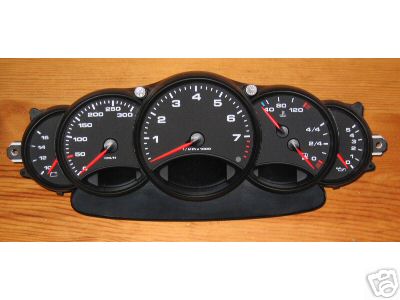

I just found a 996 cluster on ebay in France (part number 996 641 105 01 70C) that should be in order.
It looks exactly like my 97 Boxster cluster with, in addition, the battery and oil temp indicators. Cool!
The speedometer goes to 300km/h. Cool x2! But...

That is a metric 996 cluster and it should work on your Boxster. It is not from a C4. It is for a manual transmission. The same part number is also for a Canadian cluster as they are metric.
You need to deal with the fact the 996 cluster is wider at the front due to the 2 extra gauges. There are 2 ways I know of and I guess Dale came up with a third way. If you want the oil pressure gauge to work then you have to swap a wire, or install a 996 sender and run an additional wire. The volt meter will work as it is.
If the 996 cluster is a used unit with over 62 miles then the mileage will not match your car and a dealer with the PST2 cannot change it. Aftermarket companies say they can set the miles to any number you want.
If you search around here there is more info on a 996 to Boxster instrument cluster swap.

1- The cluster is a MY1998, metric, manual, just like I need. The connectors should fit.
2- The cluster is from a C2 so the fuel gauge should read the actual level.
3- The analog speedometer gauge will match the digital even if it's written 300 on the dial
4- I will not use the oil pressure gauge so I have no additional work apart from plugging the cluster.
5- The cluster has 20.000 km, so the dealer will be able to change it to the actual kms of the car (72.000km).
6- To fit the cluster in position, I will have to remove the battery and oil pressure gauges. I will also use the glass of my Boxster cluster.

I think so but not positive on #3. The digital speed on my 996 cluster had problems so I could not compare it to the analog. Bill and Jonathan have 996 clusters and Dale has a turbo cluster so they can confirm if they match.
Once the cluster has 62 miles (is that 100 metric miles?) the displayed miles cannot be changed by a dealer with the PST2 - you have to find an outside company. There are about 3 of them in the US.
You cannot easily remove the 2 extra gauges. Dale did this as he had the new style cluster from a turbo and he was simply able to unplug and then remove the 2 gauges. You have the old style cluster which is different.
