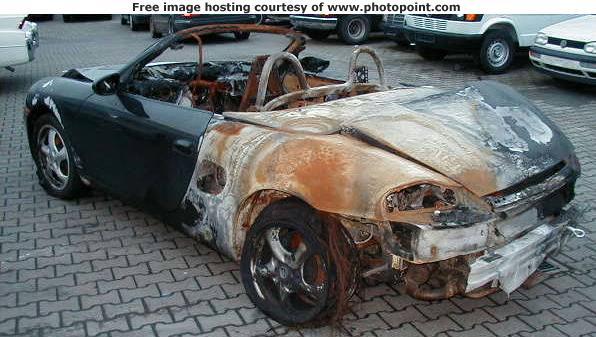

out of curiosity, what happened to that poor thing? (yes I know it was on fire at one point)
Maybe the owner was a smoker. Or a welder.

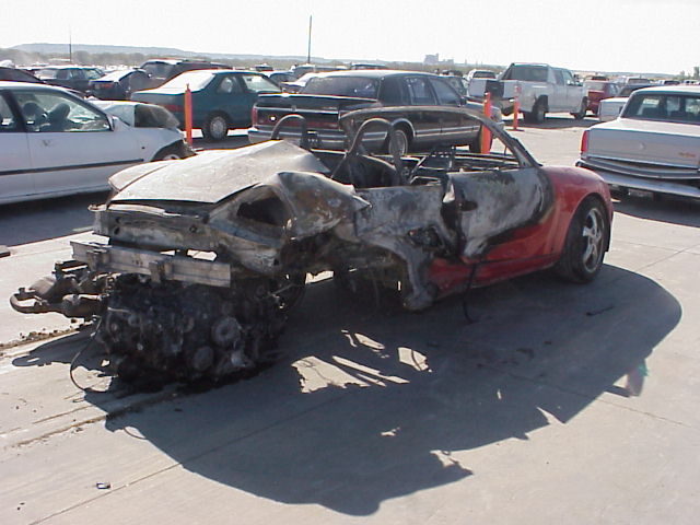

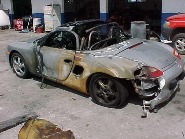

Here is another - think he was welding a muffler. :unsure:
