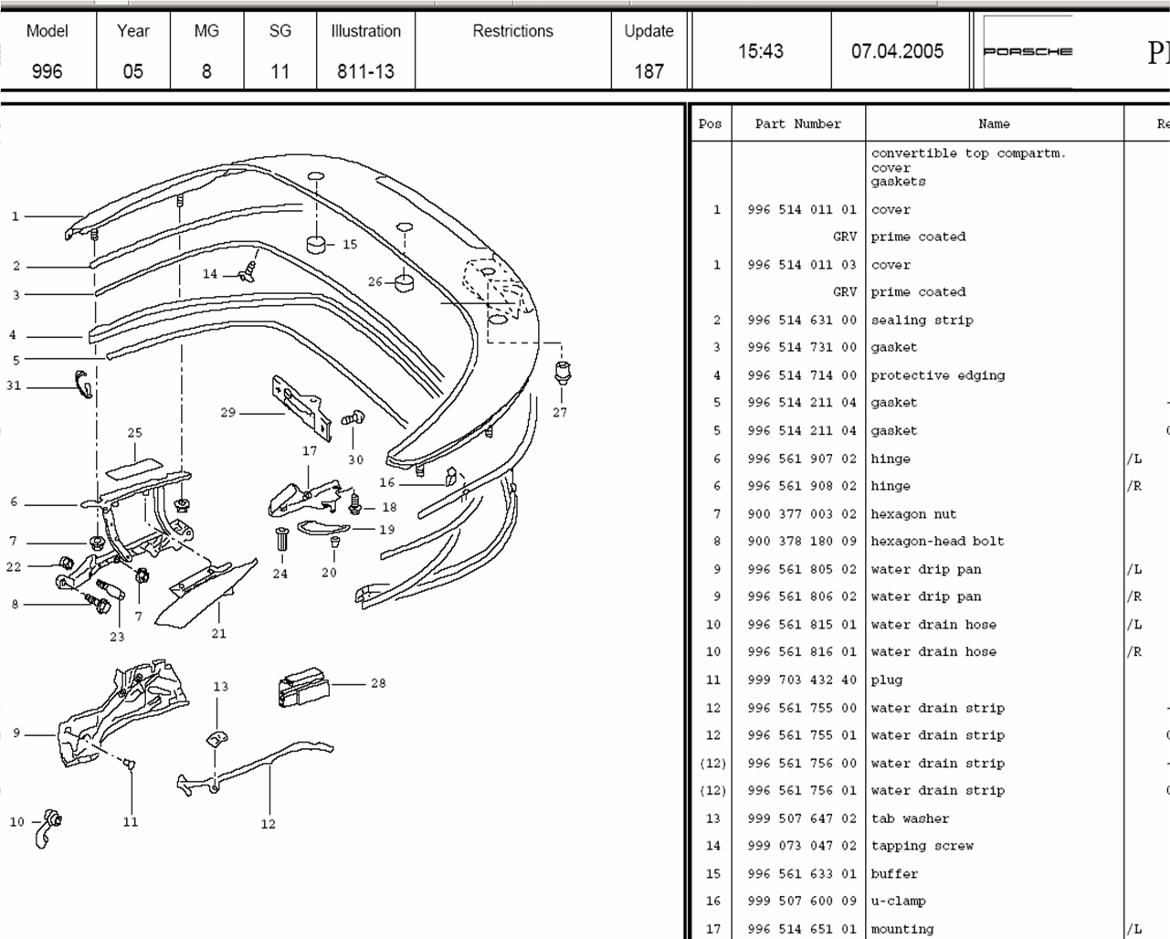

Got it. That is strange if the dealer couldn't find anything wrong. I had a problem once with the rear cover. When the cover is fully extended during the cycle, look on both sides for potentially a broken hinge part piece. It was very hard to see because it fell off and it was black like the rest of stuff in there. But replacing the part cured the problem, it was part 6 in the view below. I will see if I have other information on it.
