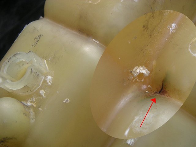

Here are the cracks in my Boxster tank.
You have the old cap, so replace it.
If it were me I would replace the suspect tank since it is already out.
TP - what is exactly wrong with the .00 cap? I upgraded to the .01, but am still trying to figure out the differences, they look almost identical... Ross
Funny, I've got my coolant tank out right now too. I would not have noticed a crack at all (showed up as a very small dark line, mabye one or two centimeters long), if it had not been for the small amount of crusty coolant that surrounded it. I too had trouble getting mine out, and ended up actually removing the air pump thing instead of just tying it back as in the DIY on this site, that seemed to help. While mine is out I am also changing the sensor for good measure (only about 10 bucks at sunset) and the cap (I too have the '00 cap).
Thanks toolpants !! The picture helped me a lot to find the crack on my coolant tank. Here it is:
I took it to the dealership and they too confirmed it to be cracked and recommended that I put in a the newer tank, newer cap, a new sensor and new coolant.
My coolant tank should arrive from sunset late next week, so till then the car is lonely in the garage ! BTW, sunset will save me almost $100 against my local dealership (which is one of the inexpensive ones in southern california!).

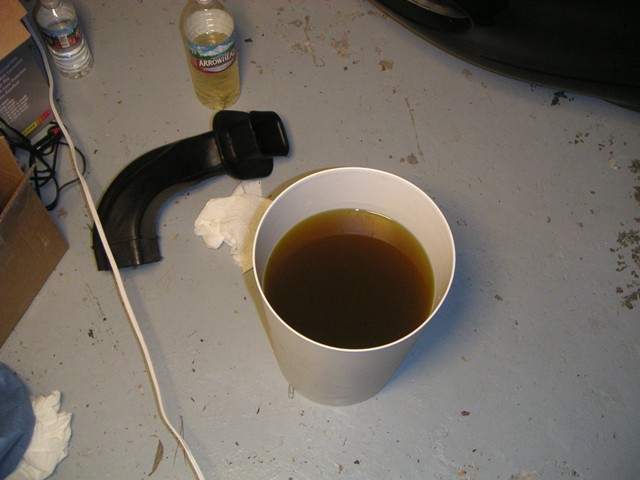

One final question before wrapping up ... should I put in newer coolant or reuse the existing drained coolant ? I've attached a photo of my drained coolant.
One technician told me to reuse another told me to put in new. He did mention that the new will mix with the existing trapped in the system (since I didn't do a pressure flush) but said its still better than just reusing the existing one.
What do you guys think ??
BTW, the coolant in the photo appears very dark but the coolant is green when in a shallow cup and there isin't any oil or even suspended stuff. I guess when seeing over 1 foot in depth of coolant it appears dark. But this is normal I suppose ??
