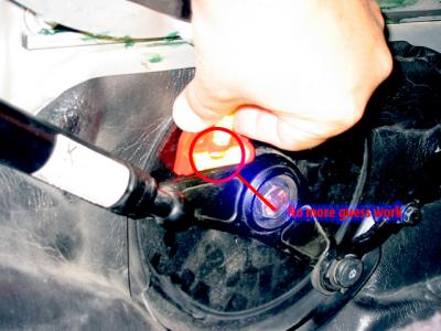

While I was working on my top repair, I came to use bubble level to synch my top transmission.
It seems to work perfect and no more guess work. Sync driver side first with attach cable to drill and just watch bubble level and do the same to passenger side.
