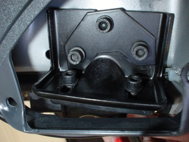

You don't need to remove the panels. Get a 7-9 inch 5mm Hex wrench. Put the bolt on the wrench- put a plastic bag over the tip of the bolt and punch through the bag just enough for the bolt to thread (preventing the bolt from falling off and down the side of the car) and then angle the bolt to the spinlock area. The top must be up and it helps if you have a little flashlight to illuminate the spinlock.
... and it helps if you have a little flashlight to illuminate the spinlock.
:lol: Yep, I had an LED heat torch on when trying to fit mine. Exactly as described by 'AS2003' fit the spinlocks with the hood down, raise the roof and you can get in with a long 5mm Alen key (wrench). Instead of the plastic bag technique, I utilised the piece of string technique. The head of the spinlock bolt is big enough to tie a piece of string round, keep it taught and once the bolt bites you can just pull hard on the string to pull your knot out.

You will need to adjust the top to the car with these allen bolts. They are under a plastic cover on each side of the top.

Although the hard top locks in place. The fit is not quite 'right'. I suspect I need to adjust the hard top to fit my car. Can you tell me where these allen bolts are located? Near the spin lock bolts ?

Covered in post #6 with a picture.
Thanks. I saw the link. I am not sure how to adjust the top so there is a good seal. So there is no leak (at the top of the windshield and windows when it is up). Also so the door can close without sticking.
