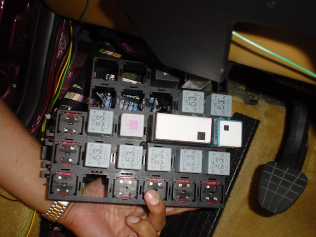

The relay tray is under the dash to the right of the fuse box.
The top relay is twice the size of the other relays. You can reach under the dash in unplug it.

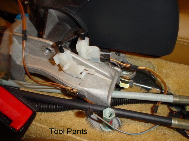

You need to replace the switch for the parking brake. Remove the center console like you were going to put in a short shift. Search around for the B&M short shift install which shows how to remove the console.
The switch is white with a black plunger on the top. When the brake lever goes up and down so does the plunger. You can see 2 switches in the picture as I was getting ready to swap the old with the new switch.
Strange for your 2001 since Porsche started using the "improved" switch in July 17, 2000 for cars sold as model year 2001, unless you have an early 2001.
