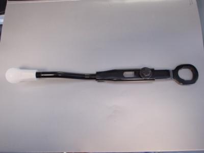

i have a 986 boxster 2001 and this 2 pieces got broke can someone tell me where i can find it, or just the part number thanks for you help
this 2 pieces are for the roof to open and close by it self...

I believe the part# is 986 561 279 02 (push rod). I also think I may have read somewhere else that this part may have been updated with a superior "ball socket" on it. JP

The above is the correct part number that corresponds to the picture you posted. It is also the latest, no upgrades beyond that.
There is another part with the same name in the roof mechanism so go by the number not the name.

Pretty much exactly what you would expect something called a push rod to do.... haha. Its connected to the transmissions and the main bow. When you push the cabtop button, the push arms turn the motion of the transmissions into movement of the top.
