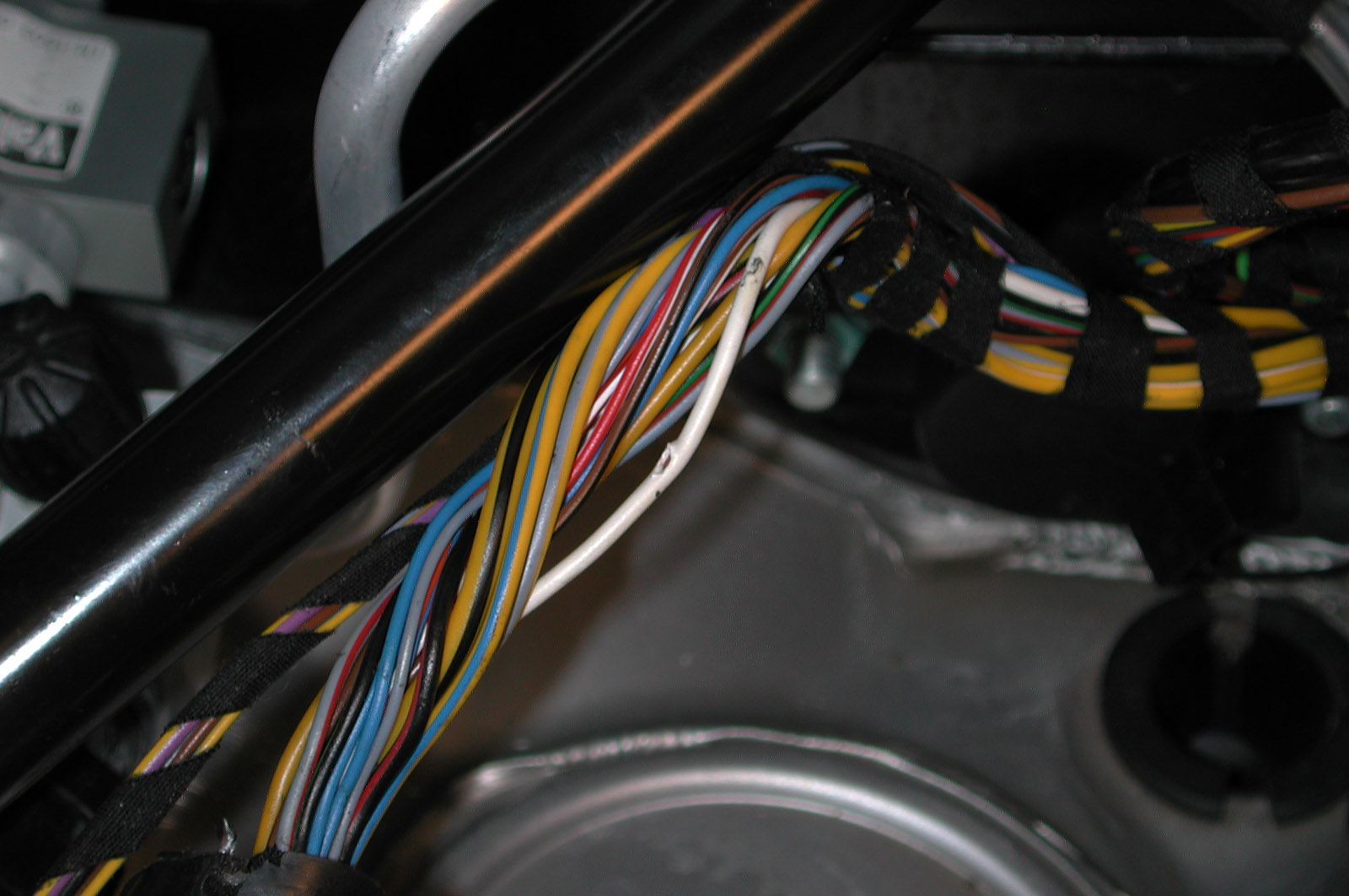

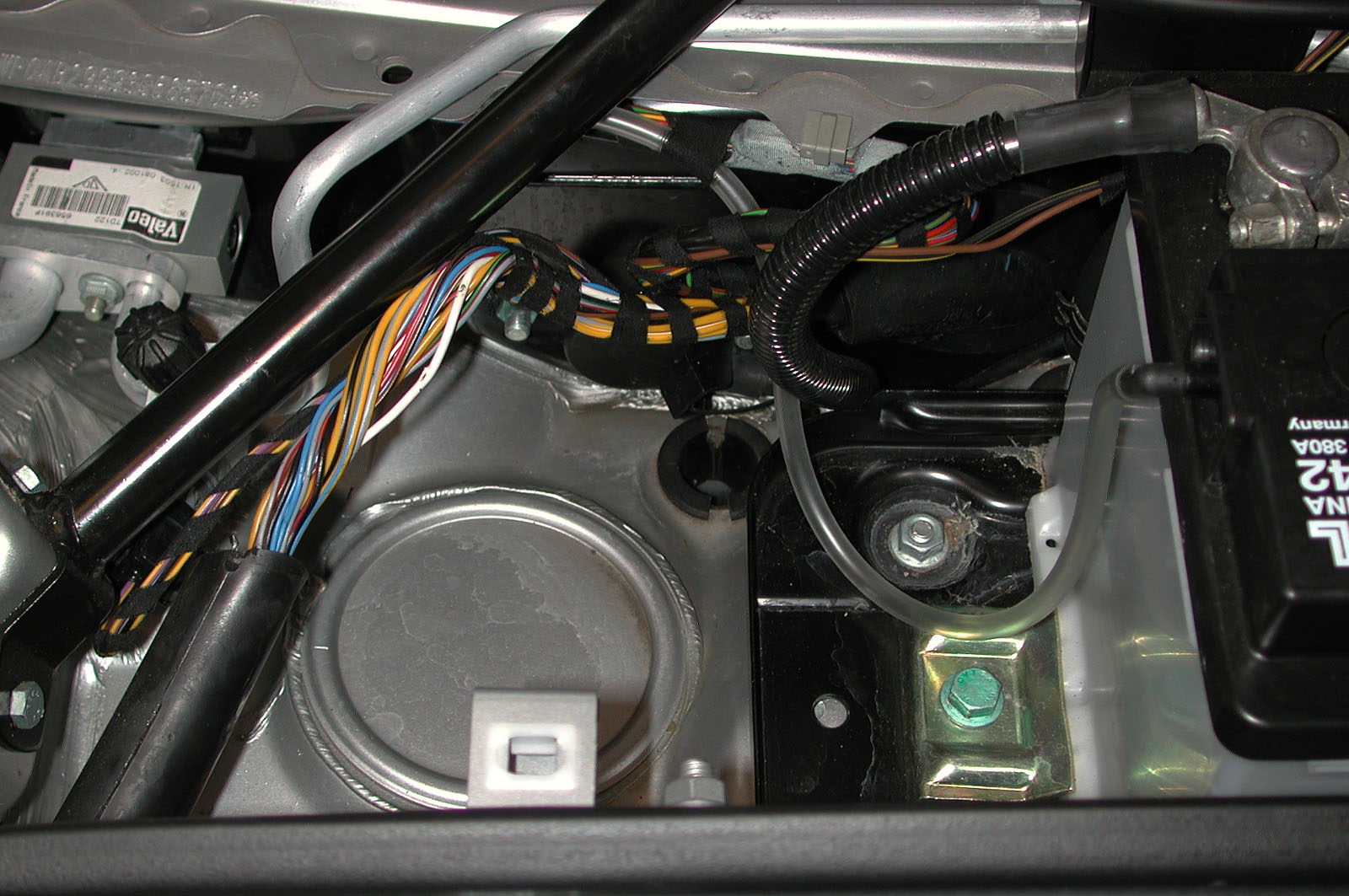

Joe ... the DIY I followed was not from a manufacturer. I just used the flash to pass wire lead to provide power for my own 12v opener, taking the place of the battery. The lead sounds like it should be the same you are asking about, however. Its in a bundle just to the passenger side of the battery. When you think you've found it, use a test light to make sure. Take a look at these.

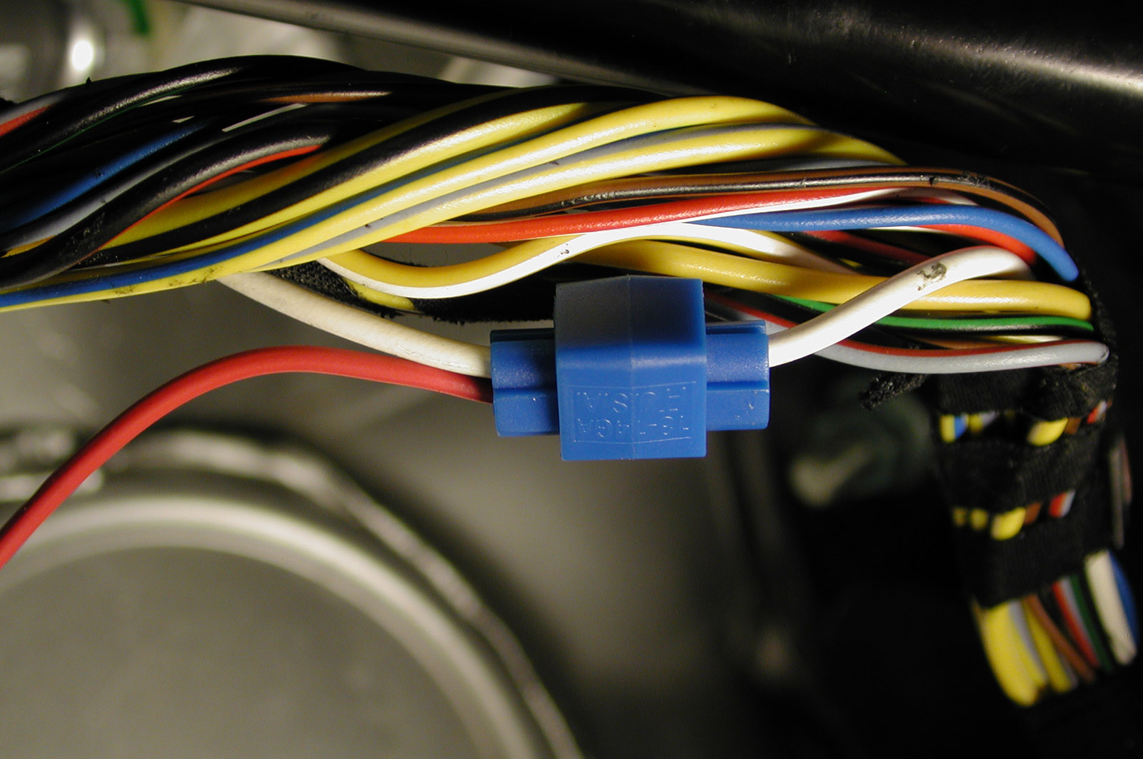

Thanks, that is exactly what I was looking for.

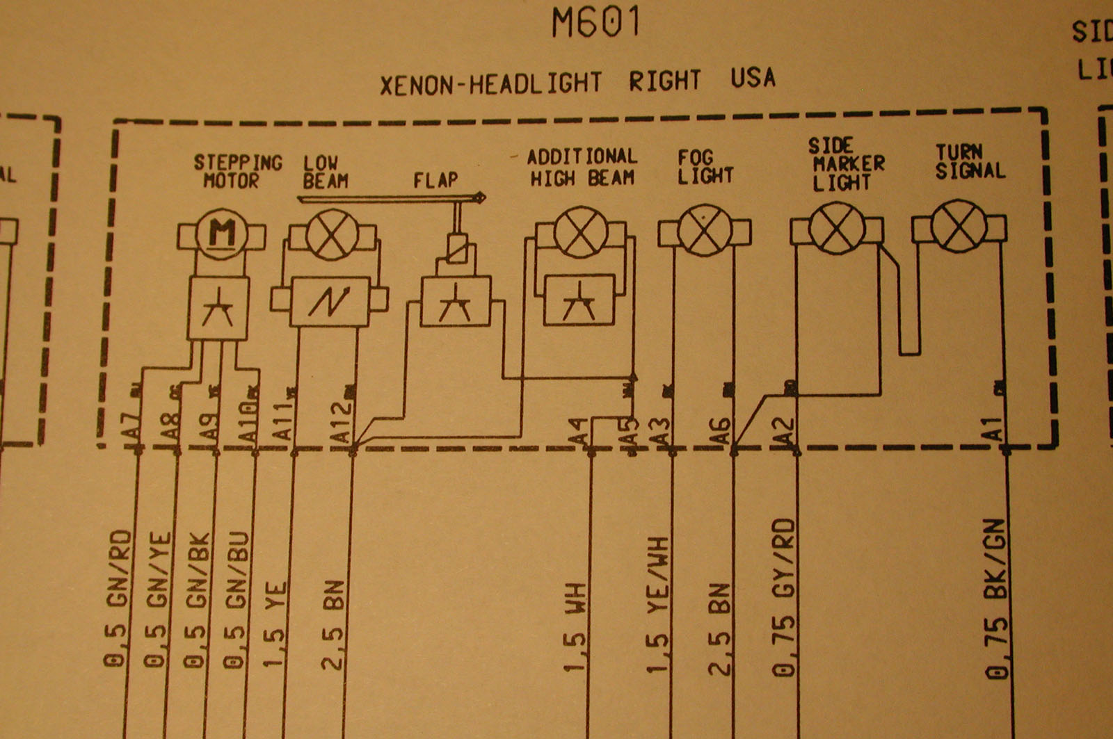

Wiring diagram of the headlight. Will use the white wire that powers the flash to pass headlight.
Next 2 photos show an easy place to access this wire. Just to the passenger side of the battery in a bundle of wires.
Use a wire tap to connect the positive lead to the white wire.
