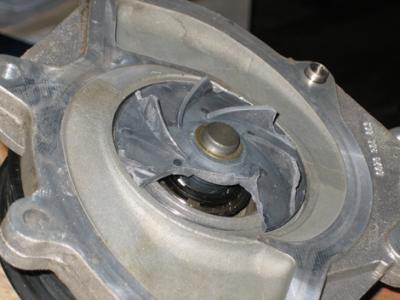

How you don't want to find your water pump...
See Picture attachment. This is my water pump after removal. Not in good shape. Wondering where the bits of plastic came to rest. Car is running well so hopefully they are resting in the sump and will stay there.
Mark.
I flushed a few times and a couple of little bits came out but the big piece is still in there somewhere... :unsure:
Anyone know if the pumps can be traded in for refurbish (and who would do it)?

The belt should be straight forward replacement - but before you install it check all the pulleys for wear or wobble. Replace any that are questionable. A broken pulley when the engine is running can do a lot of damage.
Usually a coolant system reverse flush should remove the broken impeller bits. Most collect the pieces so they have an idea whether all or most all the pieces are there. Most commercial shops would do the same.
Napa carries remanufactured pumps for about $150, but mine only lasted six months (~ 7k miles) before the bearings were shot, and it was leaking again. Since it was under warranty I put another Napa one on this weekend, and I've got my fingers crossed that the bad one was just a fluke. However, I would advise spending the money for a new one from Porsche.
