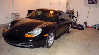

Attached is a bad photo of my car after I put only the side skirts (I) on. It helps a lot, the car looks a little thin in the middle without them. The thing I noticed after that was how short (height) the front bumper is compared to the aerokit front bumpers (I & II). I plan to do the whole kit as the mod budget allows.
Install was pretty easy, I used 3M double sided adhesive tape on the top and the supplied hardware for the bottom which is a really cool set of snap on brackets that hold the torx bolts. There is a little fidgeting around to get the brackets to line up with the holes in the skirt, but there is no real "gotcha" on this project.
The tape will grab better in warm weather, I put mine on in February and even here in socal, ended up using a hair dryer to heat it up. The tape is 3M #06383, I read somewhere that people had used this with good results to re-attach the top edge of the skirts that had come loose on factory installed kits.
