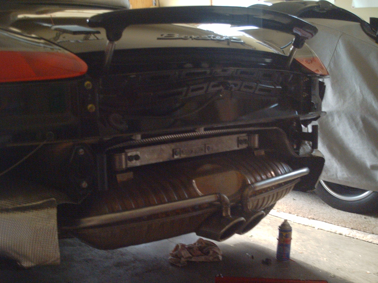

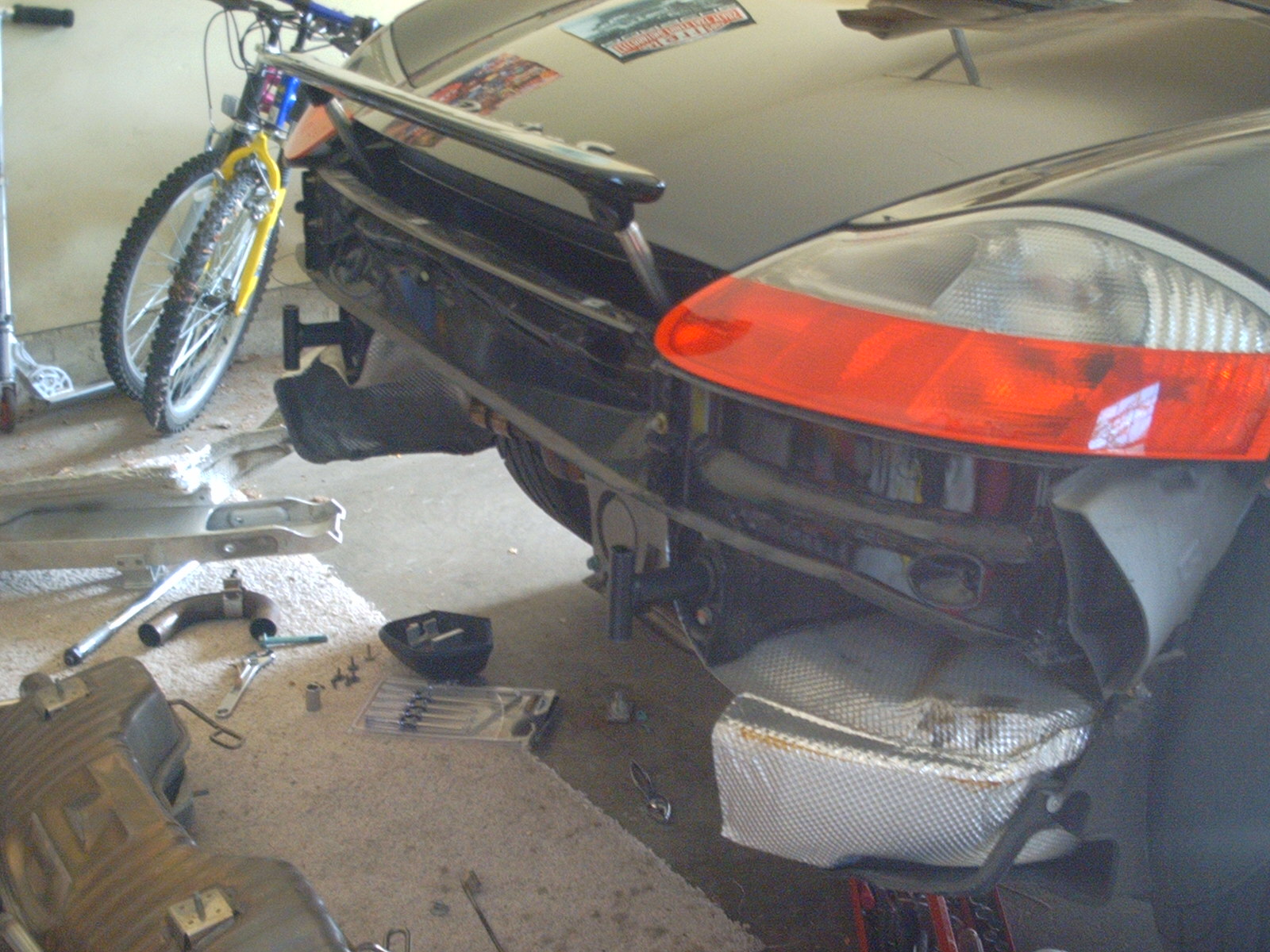

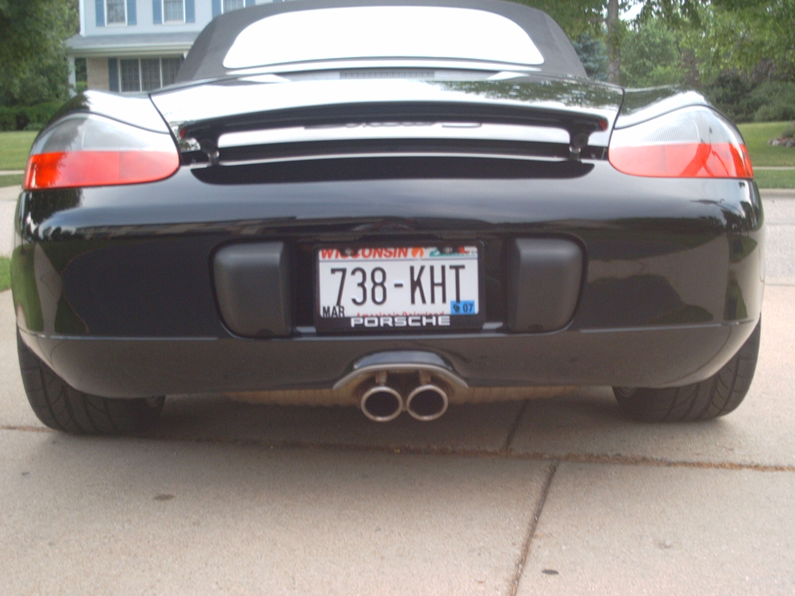

Weeks back Alex911s was kind enough to sell me his unused H&R Sport Springs, as well as his german modified Sport muffler. My car is an'02 S with around 9200 miles. Well, the springs are on and the car looks and handles great (not as good as my track 911, but good). Today, I finally had time to put on the sport muffler. As you'll see from the next couple of pics, I took the remove everything from the back route. It's very simple and the job was done quickly, even with all my cleaning, etc. The clamps were easy to break (with a little WD40). The sport muffler is a factory muffler with extra "sound tubes" placed factory style, but above the valance for a discrete look. Sound is very good; deeper tone at idle, but "lets go" as you get into the revs (I also have the EVO High Flow kit). Around town, normal cruising doesn't sound much different, just more pronounced. I'm taking it to Road America this weekend for a little 2 hour trip. I'll most likely experience all the tones she has to offer.

Hi Jerry, this is the exhaust from the german company.... you are the only one i hear from who now has the same exhaust as me....
I absolutely love it: throaty when you want but not intrusive a cruising speeds...
What do you think about it?

Hi Eric,
