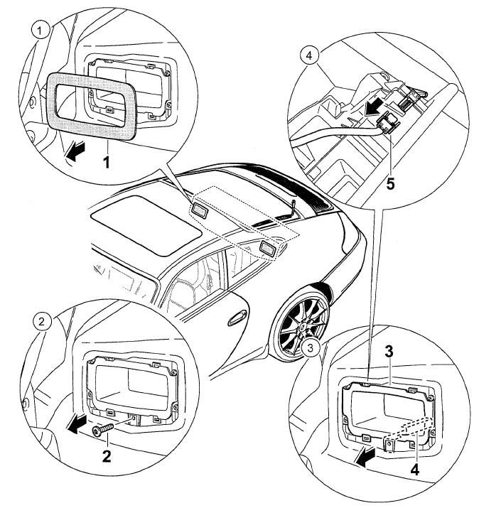

Hi,
I need the instruction to remove the Bose rear speaker box behind rear seats. Thanks in advance.
:renntech:
Edited by PorscheFan
1. Removing cover trim -- Remove the cover trim 1 at the left and right towards the front.
2. Undoing fastening screw -- Unscrew the fastening screw 2 at the left and right.
3. Pulling out the sound package -- Pull the sound package 3 in the direction of the arrow out of the bracket 4 and fold over.
4. Disconnecting the plug connection -- Press plugs 5 together and pull apart.
