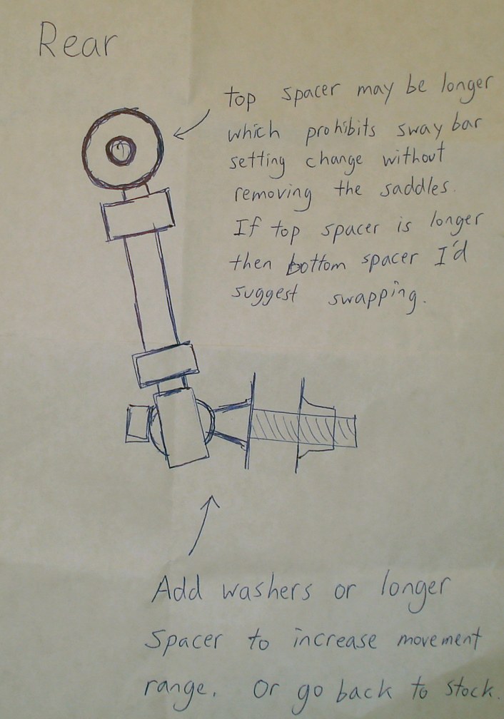

After I installed Tarett drop links on my 997 GT3, I took the car in for a track alignment at TPC Racing. They gave me a hand-drawn note about the drop links and suggested that these are not suitable for the 997 GT3. Take a look at the attached photo I took of the note. Any comments greatly appreciated. Dsc02015.jpg

I just broke another one. There is not much you can do to improve the life of the links. The banjo bolt produces a lot of vertical stress. The threads on the nuts wear out. I have to dig under my car but I think the banjo bolt sheared at the threads. Yes I have a bigger a thicker sway bar to reduce roll. Paul
