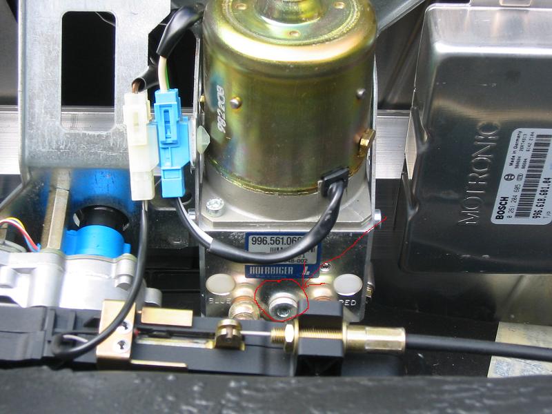

So I've disconnected the 2 top cables, removed the trim and can see the reservior, but what's the best way to fill it?
I've read that there's a hex head plug in the fill hole right above the reservoir. Is what I have circled in the picture the plug?
If so, does it just simply unscrew (counter-clockwise) and you funnel the fluid in the resevoir?
It's tight and I just want to make sure that I'm not screwing it up. Any other tips?

That is exactly what I did. It was very tight but it worked. BTW, what fluid are you using? I went and bought the MB bottle for about half of the Pcar price.
