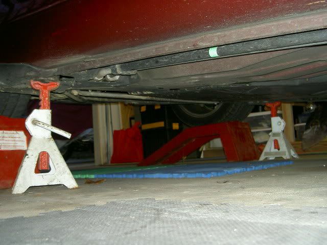

BTW, it took me more time to figure out how to jack-up and secure the car than it did to perform the actual task. I'll post pics in the am.

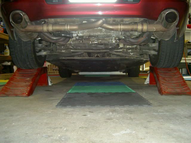

Guys, after scratching the slow part of me, and using a few choice words in 4 languages (darn German engineers try to force you into having to use their dealer's lift for under the car work) I decided to jack-up the rear of the driver's side until I could slide a ramp under the wheel and then released the jack. I did the same on the passenger’s side and then used jack stands for a bit of extra safety (activate the emergency brake to make sure car does not roll frontward or backward).

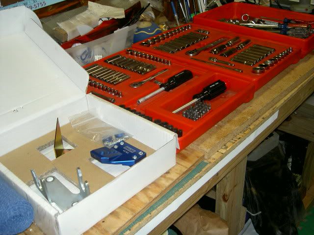

I then got my tools and parts ready, I’m the orderly type.

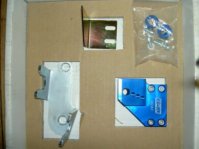

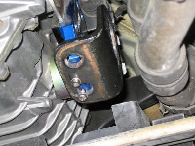

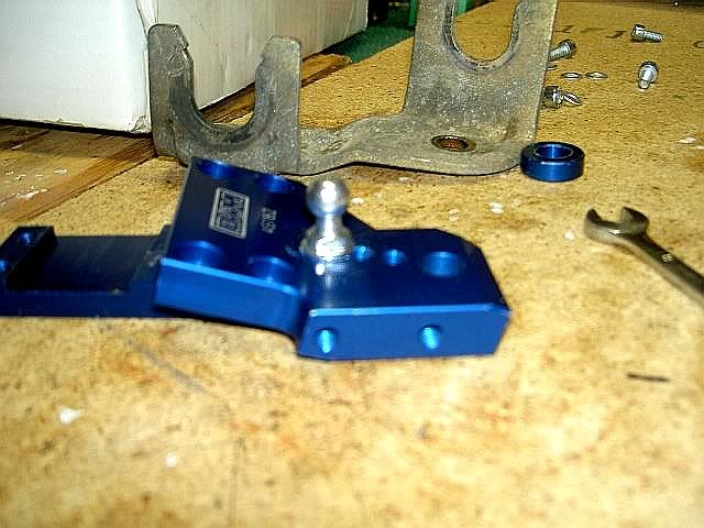

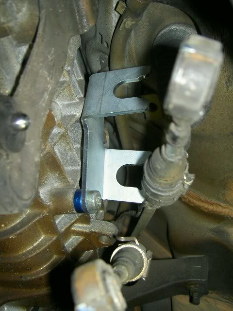

I crawled under the car, removed the cross bracket and set it aside. I then un-snapped with a straight screw drive the ball joint connectors of both shifter cables, un-mounted the cables from the OEM bracket and removed/replaced it with the B&M bracket, making sure I used the spacer provided for the lower hole (once you compare the shape of the two brackets you will understand why).

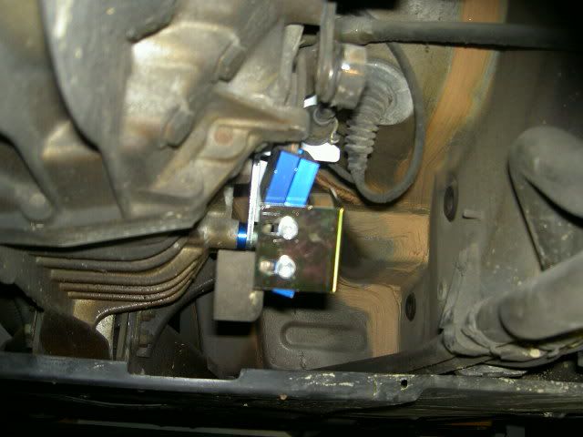

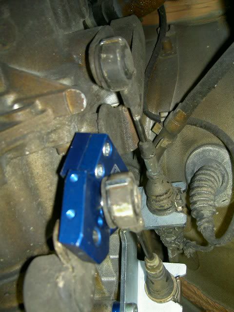

Then I installed the ball joint onto the blue flat wedge plate (I used the hole closest to the center of the assembly since this hole provides for 30% reduction but there are two other hole you could also use for more shifter throw....but in my mind at least this defeats the purpose of the install).

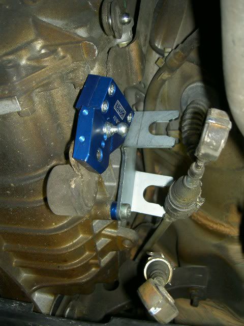

I secured the wedge plate to the lower ball-joint arm and re-attached the cables onto the 2 ball joints (one new one old).
Installed the protective bracket and tested the shifting to make sure all is well, before I started the car.
Lowered the car, (didn't test drive it yet since it was raining last night), patted myself on the back for a job well done and then went in to enjoy the beer & grilled wild pork my wife prepared for me while I was playing mechanic. I’d like to add that the shifting difference is next to amazing, crisp, short and precise!

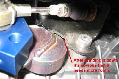

I got the same kit last year and had the "compensating weight" hitting the bracket when in gear. I had to grind off some material from the new bracket to make sure it doesn't happen. Make sure you test yours for this. Your bracket would also need to be painted if you decides to grind it down some so it won't rust.
After the install, I kept feeling that the shifting became too notchy. I was recommending to everyone against upgrading to a SSK in the 996.
After a lot of thoughts and looking at the concept from my M5's SSK with really heavy oversized SS rod made me realize that the notchy shifting is caused by that the overall weight of the shifter is not heavy enough to match the more effort required. When the shifter is shortened, the compensating weight that Porsche built in is now not enough. I decided to find a heavy item to add to it. The screwed in thin sheet metal guard that came with B&M kit gives me the perfect place to add weight. I found a cast iron tow hook that I took off a Sequia with similar size but weighs a ton. I drill the proper holes, find the longer screws and bolt it on. Went out for a test drive. Whoa, the factory shift feel is back. It's not that pretty but gets the job done. I'm now considering adding even more weight.
