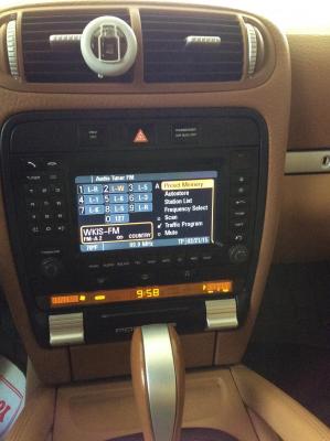

  2. Grdlaw, That sounds like a daunting process. I can tell you 2006 and the PCM 2.1, but posting a pic is going to require that I research the FAQs for the forum (I'm new here although my first Porsche was in 1990). I will do that and post, though he fully you guys can garner something from the info I've given here, '06, PCM 2.1.
  3. Whoa! This is really a key thing to know. What I'd really like to get it is whether I would still need the MOST-HUR955 Fiber Optic head unit even though I don't have a Bose system.
  4. That looks dazzling, grdlaw. That's exactly what I'm looking for. How much was the installation proportional to the system itself? I'm quoted anywhere from $179 (by folks who have installed stuff for me before and whom I trust) to almost $700 (by Best Buy). It does not appear that I have the premium Bose "most" unit. Advice is appreciated, folks, and I thank you for it.
  5. Hi Folks, I'm new here though I have been lurking and learning for a little while. I'm wondering if anyone has gotten CarPlay radios to work with their Cayennes (mine is an 06), or if someone may be able to suggest a process whose installation inst as costly as the receiver itself. I'm looking at the beautiful and intuitive Alpine i007 (or ix007). The back is half the length so presumptively an installation would be simplified, but no idea. It's the interface that gets me. Nothing fancy; nothing that says "we're trying to make EVERY phone in the world work with this." Very clean. Let me know if you have suggestions, folks, and particularly in the Sputh Florida Area. I'll post those pics once it's installed and you'll love it. Thank you, Jesus
