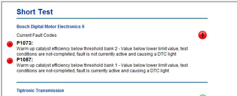

  1. Tried clearing the codes 4 times, but P1057 and P1073 keep coming back after driving some miles. Any insight on how to check this issue would be helpful.
  2. There was a vacuum leak. Break booster hose was split, have replaced it. System too lean codes have cleared but below two codes(P1073 and P1057) have persisted Please advise how to solve this.
  3. Not able to understand what could have caused these fault in 08 Cayenne Base. Please guide me on how to further investigate this
