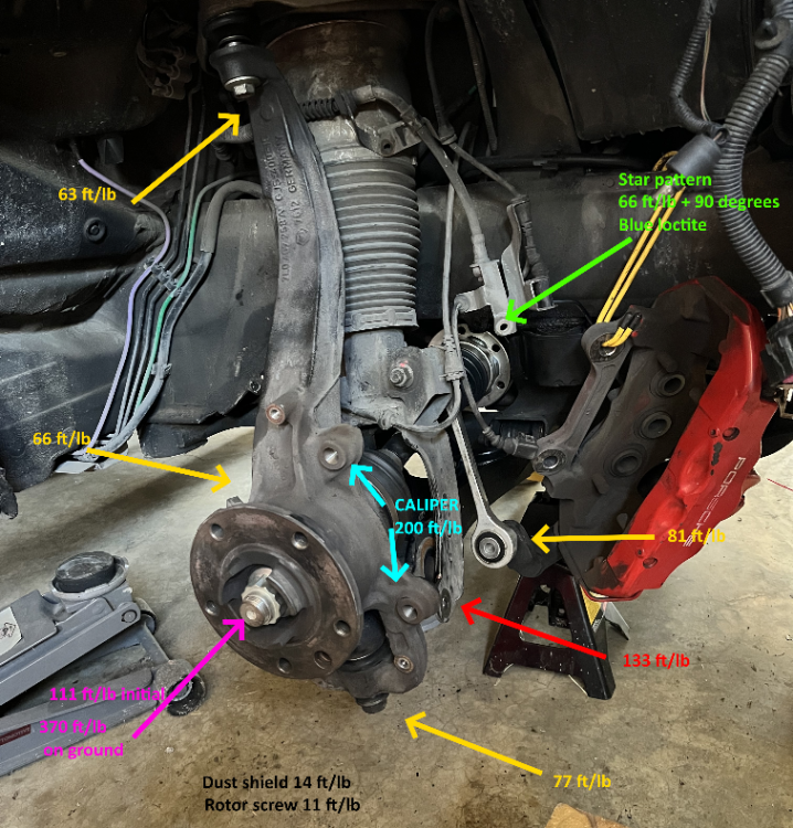

  1. Hi guys. Just replaced a CV axle in my 06 CTTS. Ready to button things up, but when I search for torque values, I'm finding different information from different sources. I made a little cheat sheet to take out the to garage - do these values seem right? Also, the one in pink and red are supposed to have final torque while the car is back on the ground? For the rest, can I use a jack to simulate the suspension being on the ground? (Jack it up until the upper control arm is at 90 degrees?) Thanks, any advice appreciated! pf
