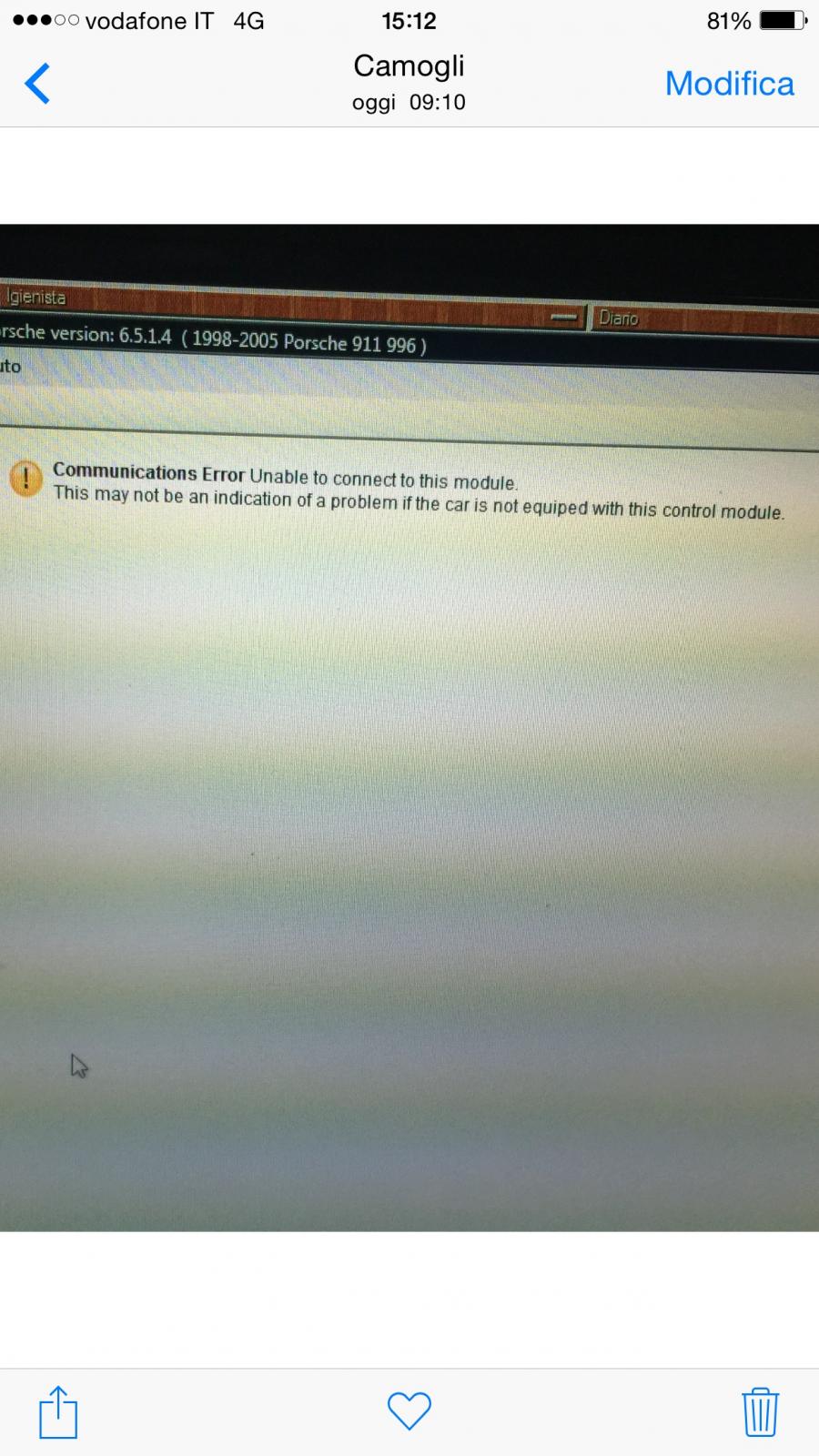

  11. Engine module and Tiptronic are identified, as well as instrument cluster, but with the other modules there is this error message:

  13. At last ABS unit has been mounted, regular bleeding done and pedal was very stiff! Durametric arrived but when I connected it, I had the (bad) surprise to see that communication with a lot of unit was not possible. Any suggestion?

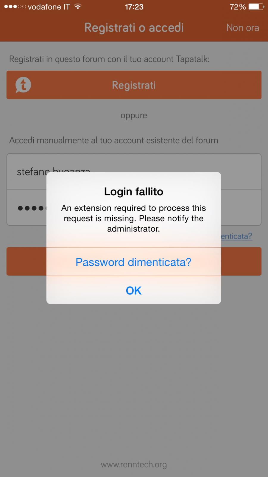

  14. Hello, When I try to login through Tapatalk, I receive the following error message. Maybe because I registered myself with Facebook? Stefano
