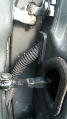

  4. Looks like it's different in 2nd gen cars: No connector here, the cable goes inside the door. So it's not possible to check for water damage without removing the panel.
  5. The wiring looks fine on the outside and checking the connector inside will require removing the door panel. But this sounds promising. The water did go inside the door near the hinge. If the door computer has trouble communicating with the outside world it would have trouble controlling the passenger side window, like it is.
