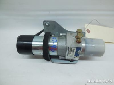

  1. Unfortunately no, that seems to be what the older 996s had. For the newer 996s including the turbos, it seems they switched to a different pump. I have attached a picture I found online, my pump looks like this one and is orientated horizontally with the reservoir toward the inside (driver's side) of the car.

  6. Hey there, new 2004 996TT Cabrio owner here! I picked up my 996 Turbo Cabriolet a few weeks ago and have noticed the top is slow to go up and down (especially back up) as well as making some odd noises. I've done quite a bit of reading online as well as searched this forum, and while I found a couple DIYs on how to replace the fluid, it seems the hydraulic pump on our Turbos is different from that on earlier 996s. So, here's my current situation: -Top is slow to go up and down -I put the top in service position and removed the rear carpeted cover. Hydraulic fluid seems to be at the correct level and I did not see any leaks throughout the compartment. And here are my questions (and I really do appreciate any help, thanks guys!): -Is the main issue in my situation most likely the fluid? I've read the fluid can go bad and sometimes needs to be replaced. -I have some small diameter tubing as well as a syringe and have removed the pump, but I've not been able to get the syringe to extract any fluid. Is there a trick or do you need a special tool (or have the pump at a certain angle) to remove the old fluid? Thank you again for any help you can provide, it's great to be a part of this community!
