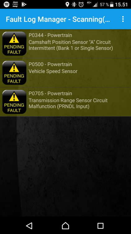

  3. Hi. Need help sorting fault code P0344 - Camshaft position sensor "A" circuit intermittent(bank 1 or single sensor) And P0705 Transmission range sensor Circuit malfunction(PRNDL input) Some times i also get P0500 Vehicle speed sensor.With this faults i get check engine lamp. transmission goes to limp mode(shows the solid D in display) Rev limit is 4000rpm. I have changed both cam sensors, transmission range sensor, transmission control unit and battery. Cleaned all electric contacts using a few bottles of elecrical cleaner and brushed all groundings i can find. Engine has only run 62000 miles and seems to be in good shape. Porsche center used a full day checking engine timing, Measured cam sensors and harness and this is spot on. So it had to be a bad ecu causing both transmission and engine faults. I have now replaced ecu but i get the same fauts. The only difference is a smaller wallet.
