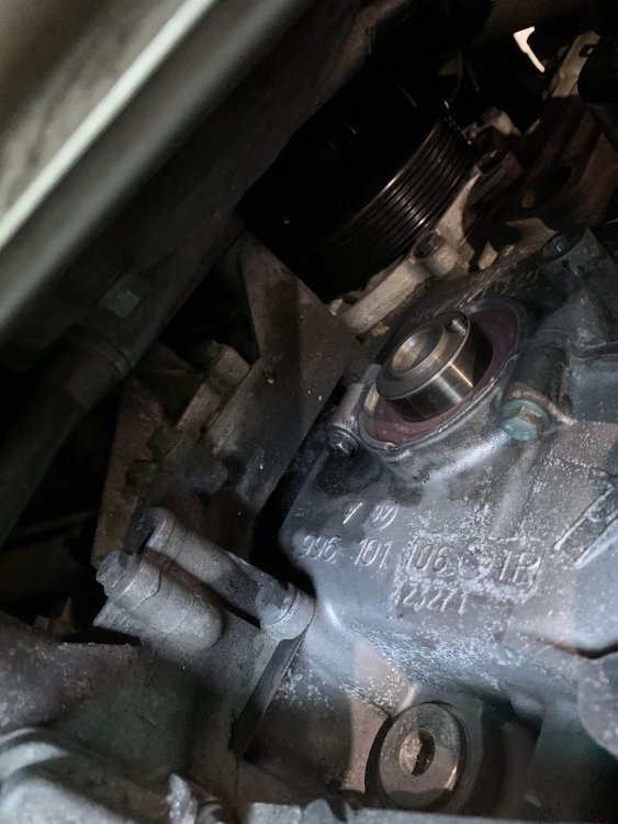

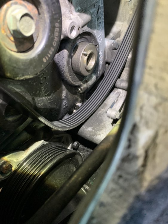

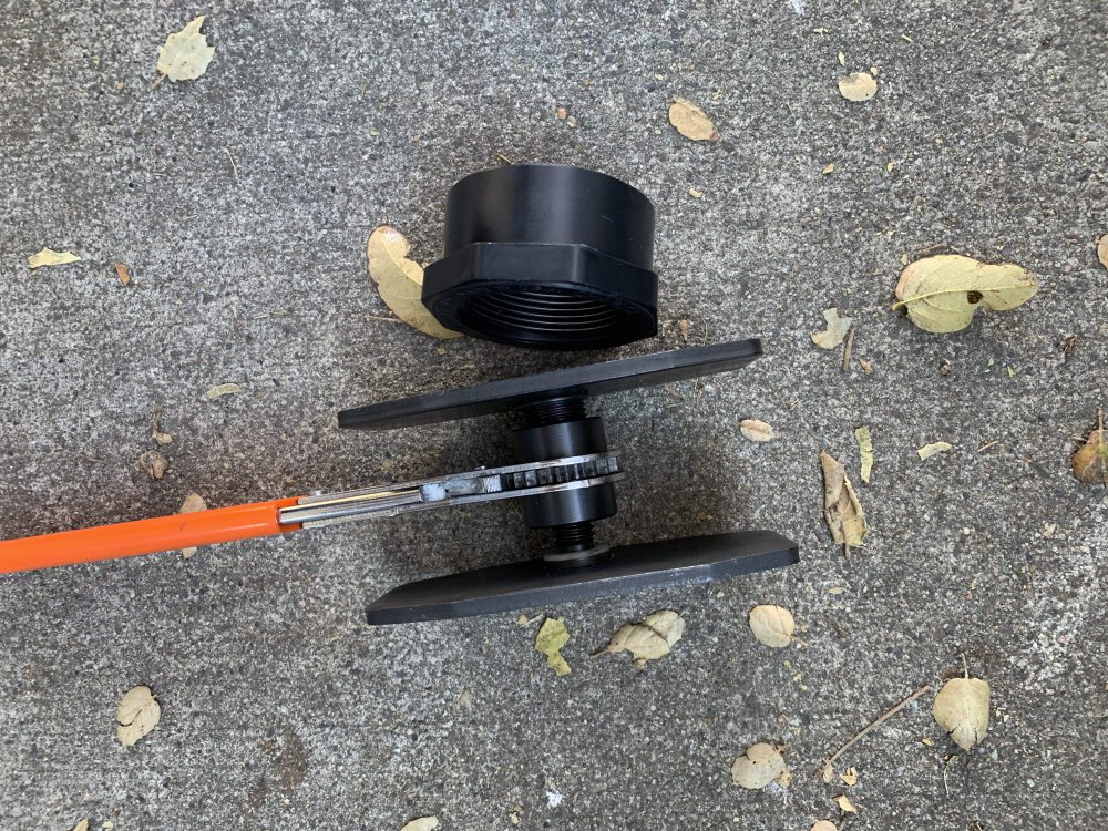

  1. Well, I may have just had the first FMS leak on my 1997 boxster! Noticed a very small leak...not enough to cause even a few drips on the driveway, but enough to be slightly wet under the crank pulley. I removed the pulley thanks to this video: https://www.youtube.com/watch?v=ldmfY2lPJh8 I was surprised that no one else had covered replacing this seal..must be very uncommon...but with a 23 yr old car, anything is possible (like 2020:) I got the seal out using a limited access tool like this one: https://www.amazon.com/Lisle-56920-Limited-Access-Puller/dp/B002MCVPVM I did find some very minor pitting at the bottom of the opening which I filled with JB Weld and sanded smooth. For the installation I used a 2 inch pic fitting and a brake caliper tool to push against the bulkhead forward of the engine...worked like a champ.
