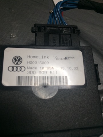

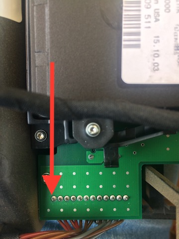

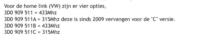

  1. hi dear, i've found this topic and i try to clear. Well the cable from the chassis isn't complete on my Cay 04 Base. the plug of three wires it's complete, but, the first red isn't under 12v. Red arrow on mother board isn't under 12v the plug (white 3 wires) are: orange 12 v for the buttons lights led brown ground red: 12 v switch on the homelink but... check the serial number before you buy. the Homelink can be works in Single Code or Rolling Code. Check your Electronic Gate or radiocontrol my Elvox system works on 433.92 mhz in rolling code. now isn't listen the new code :( Francesco.
