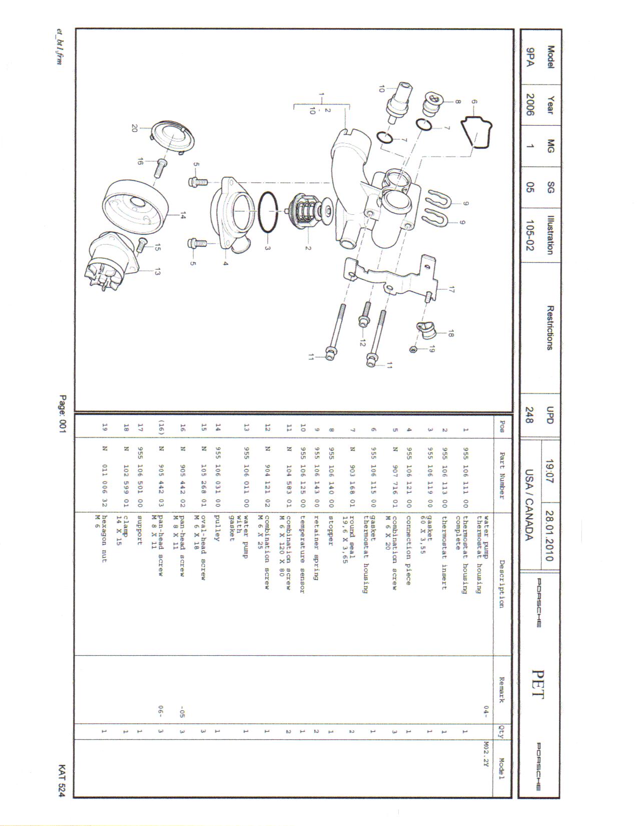

  3. Loren, R u sure theres only 2 bolts thru the housing? Illustration 105-02 in the parts manual shows 2 long ones thru the bracket support and a 3rd smaller on to the right of the support..........its showing 2 for the round thermostat connection piece on the bottom............
  4. On the V6 3.2L Cayenne the thermostat housing is on the rear left of the engine. First car I've ever seen with this setup. There are what looks like 4 hoses and 3 allen head bolts that hold the housing to the back of the motor, and a sensor connector. I can see 2 of the bolts clearly (ones on the bracket) but the 3rd is further back and I cannot see it. Maybe once the hoses come off it can be easier seen. BUT before I attempt this repair I want to make sure of all the steps. The shop manual actually refers to the thermostat itself when referring to removal of the transmission. I would think if the housing and the thermostat come off together you wouldn't have to remove the transmission. Then remove the thermostat from the housing. Otherwise whoever designed this needs to have their brain examined. This video looks similar to the location and a great example of what not to do.!!!!!
  5. 2006 Cayenne 3.2L V6 with 67000 miles. I have a teeny coolant leak coming from the thermostat housing area on the left rear of the engine. The leak is very small and does not drip on the floor, at least for now. The service manual refers to removing the transmission to change the thermostat, at least that's the way I read it. Can the replacement of the housing be made without removing the transmission? I know it looks a little crowded back there but it mystifies me that the Porsche engineers would design it where the transmission needs removal. Any insight or experiences with this greatly appreciated. Thanks in advance George
