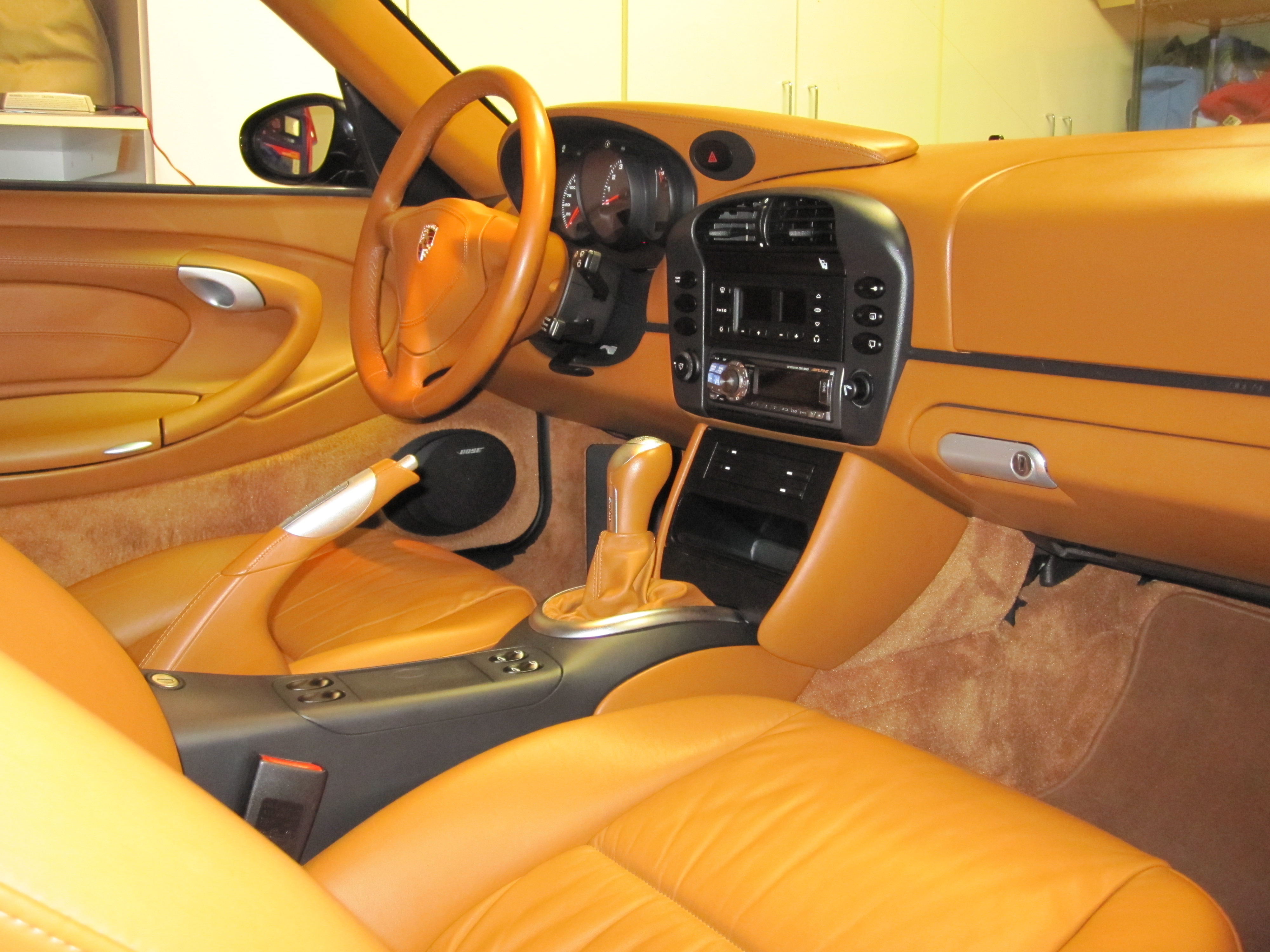

  1. It was the cigarette lighter fuse . New fuse. Now it works! So here is another pictures of my natural leather interior. Hope you like it!
