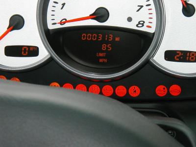

  15. OBC Update for 2003 Boxster S I recently purchased a new Boxster S without the On Board Computer. I had assumed that all the information and thermometer were in the system but had no idea that it could be added so easily. I’ve had 911’s for years but Boxster ownership was new to me. I started searching for Boxster forums, I’m a Rennlist member so was aware of that list but found many more sites that had lots of good information. I was interested when I found the OBC hack info. The Tool Man’s DVD video was good as was several other sites. I had the dealer turn on the OBC before delivery. As written in all the information, the dealer will tell you he can’t turn it on for 2003 models or does not know how. Tool Man “Jeff” supplied me with a phone number for the technician and the technician was able to speak with someone who had turned on the OBC and could give detailed instructions. I had several questions prior to attempting the update that were answered by Jeff. I ordered all the parts from the Porsche dealer including the five VW wires. I made the wiring harness prior to starting the update. With all parts in hand I had no more excuses why I couldn’t start the project. I completed the project in one afternoon, it is a straight forward task and easy if one has had experience working on cars. Anyone with tools probably could do the update, just follow the steps outlined on the DVD or other sites that give good info. Yes, after the update, everything works. I understand that the OBC on the 2003 will look like the output of a 2000 or 2001 model. I haven’t seen a 2003 with OBC so can’t describe the differences. A few screen shots for your reference. Abe
