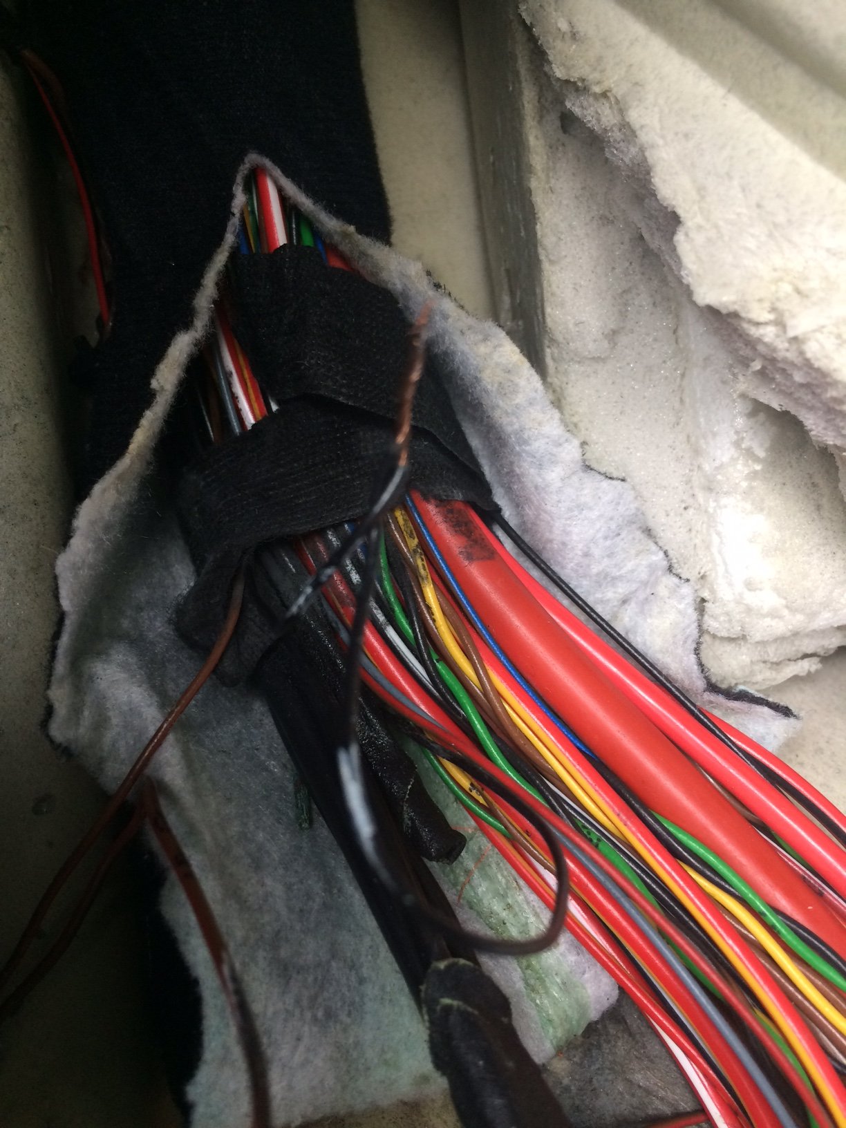

  2. Sunroof blockage I've had 8 months going around in circles trying resolve a leak in the passenger footwell (left hand side - UK). Tried all sorts, thinking it was air-con, windshield, drains, thinking it's solved and then more water. Absolutely sopping wet at times and at worse also a film of water over speaker grill and carpet under door soaked. I fixed broken cables yesterday that solved "ignition lock faulty", footwell was dry then, soaked today, only difference was it rained heavily in between which made me Author Markjames1200 Category Cayenne (9PA, 9PA1) - Common Fixes and Repairs Submitted 07/05/2017 08:29 AM Updated 07/05/2017 08:29 AM

  4. Thank you for the welcome! They were telephone connections i had at hand so used for very low voltage. A crimp connector wasn't the best description to be honest, fresh twisted bare wires placed into one cavity of the connector and crushed down, more as a device to protect the connection rather than make the connection. Then that sealed in almalgamating tape. I've no mechanical background, websites like this allow me to take on braver diy tasks than usual and save a fortune. So thank you very much.
  5. Ladies and gents, hello, had the dreaded "ignition lock faulty" warning on dash. Problem was the common water getting in from air-con (*correction - seems it was the sunroof drain) in footwell. Passenger side as I'm in the UK. All the cable loom looked fine until cutting into the fabric sleeve and found 4 groups of cables repaired. Water had got in again and started to corrode the thinner of the cables into a very delicate state. The cable that made all the difference was a very skinny single black cable. There were other bunches of (black) cables broken twisted together in bigger groups of 4 or 5 but this particular one was the thinnest of the gauges. I disconnected the battery, repaired that skinny black cable with a crimp and waterproof tape, connected the battery and the beep - beep - beep of before didn't happen. Car started, problem gone. So find that broken skinny black cable and breathe a big sigh of relief!
