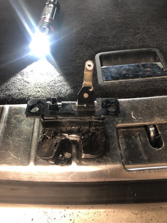

  2. Well. I posted on Rennlist, Renntech and 6speedonline. Got no responses for repair ideas so I came up with one. I took the multitool cutter to the latch and removed it. Appeared to have a failed part internally. Part that actually releases the hook was non functioning. Soft close motor works as it should when microswitch is activated. Porsche should have made a provision for removing the latch mount inside the car rather than weld it on. First photo shows latch in situ. See how the mount is welded to door. If it were bolted on, you could remove the latch mount from the door and get the door open, cut the bolts holding the latch to the latch holder that was previously bolted to the door and just replace the mount and latch rather than cut the whole bugger apart.
