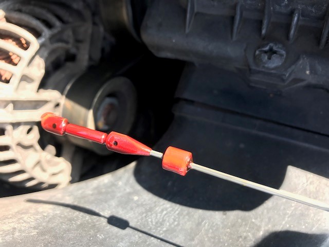

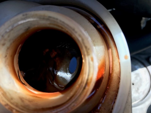

  5. Thanks Wizard. I have just opened the reservoir, it is thick dark brown oily gunk filled quite high. The oil filler tube has white mayo in it. The dipstick is clear. Pictures can be seen on my reply to hilux2011.
  6. Thanks Hilux2400 I have just opened the reservoir, it is thick dark brown oily gunk filled quite high. The oil filler tube has white mayo in it. The dipstick is clear. Pictures below:

  9. Thank you PWS, this does sound like possible promising news, and it looked like something might be spurting from somewhere on the water reservoir, but would there also be oil in the water with such an issue? As you can see oil is all over the reservoir.
