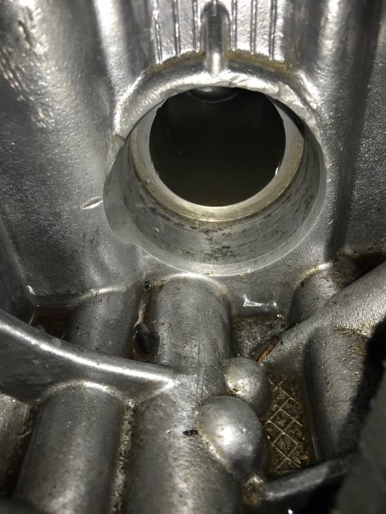

  4. Thanks lewisweller, I have seen some of your posts. Fortunately the dealer gives me a loaner car, but still it's not fun to keep going through this. I keep rinsing with hot water from my garage house the top of the motor till i see it run out the bellhousing the 2 times now that out leaked. It sounds like its when the coolant sits in there, keeps running down and building up, heats and dries forming crusties that destroys the torque pump seal, I hope. What happened with the head gaskets on yours, what symptoms did you have, and what caused it? I thought head gaskets failing on these was rare? So where should i put the rtv? I was gonna use "the right stuff" but ill compare to your suggestion, still wasnt sure where to put, cause i did see you don't want it on the orings.
  5. Hello all, I purchased my first Porsche, a 2005 Cayenne Turbo in Sep. has 44000 miles and mechanically is in great shape, no issues. With the help of this forum I budgeted to replace the coolant pipes with the upgraded alumn ones after purchase. I called around for pricing, went to a local ex porsche dealer who still has their master tech, and got them replaced. This was done proactively as the original plastic pipes were not leaking. About 500 miles later, lost a good chunk of coolant, out the bellhousing weep holes, the very thing i was trying to avoid. Dealer said pressure tested and leaking where main coolant pipe enters the block. The after market pipes orings appeared flat instead of round after removal, I sent the pipe back to the manufacturer, and they indicated the orings where softer than they should have been. So, plan was to replace with OE porsche pipe and orings so did that. All other pipes where fine, even the main couple at back distribution bank. 500 or so miles later, small drip or 2 out the bellhousing, andc the smell of coolant. Back at the dealer currently, and leaking again at the main pipe and the double orings where it enters the block, not as bad this time. The tech cleaned the mating surface in the thermostat housing good, but he mentioned it was a bit rough and pitted from corrosion and thinks that's the cause for the leak. Any ideas, what else can we try, is there something we might be doing wrong. Everyone is saying this is the first tune this had happened. Ive read other posts of pine hole leaks due to bad castings, or loose clamps, etc. But not this. Should we use rtv or an anerobic gasket maker on the mating surface? The current plan is to fine polish the mating surface in the housing to eliminate the pits, I just don't want to remove too much material so using very fine grit wet sandpaper like 2000 or 3000, then we are gonna try the Hamburg Technic pipe from ECS tunning. I got the Porsche lube as well to use sparingly. That will happen this Monday. Also, why would it pass the pressure test once the job is done, then last for a while, then leak? Ive attached some pics. Looks like they damaged the right top side of the opening a bit by prying to remove the old pipes, but its way outside the oring area. I love this truck, but ive hardly even been able to enjoy it, and regretting being proactive but know in my heart it was the right thing to do. Sorry for the long post, but need done help. Btw, the dealer suggested possibly needing to replace the top of the block to correct this, wow.
