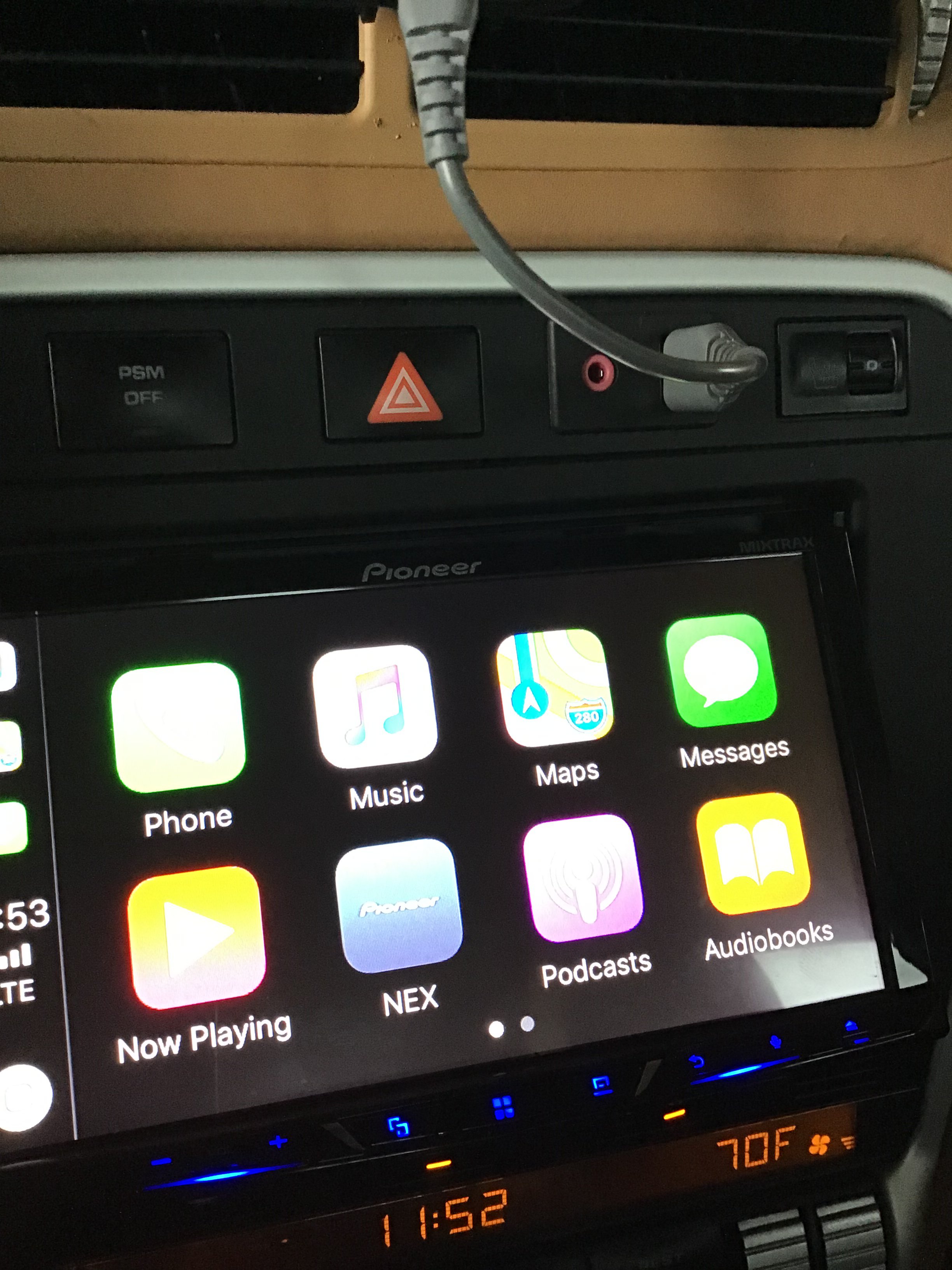

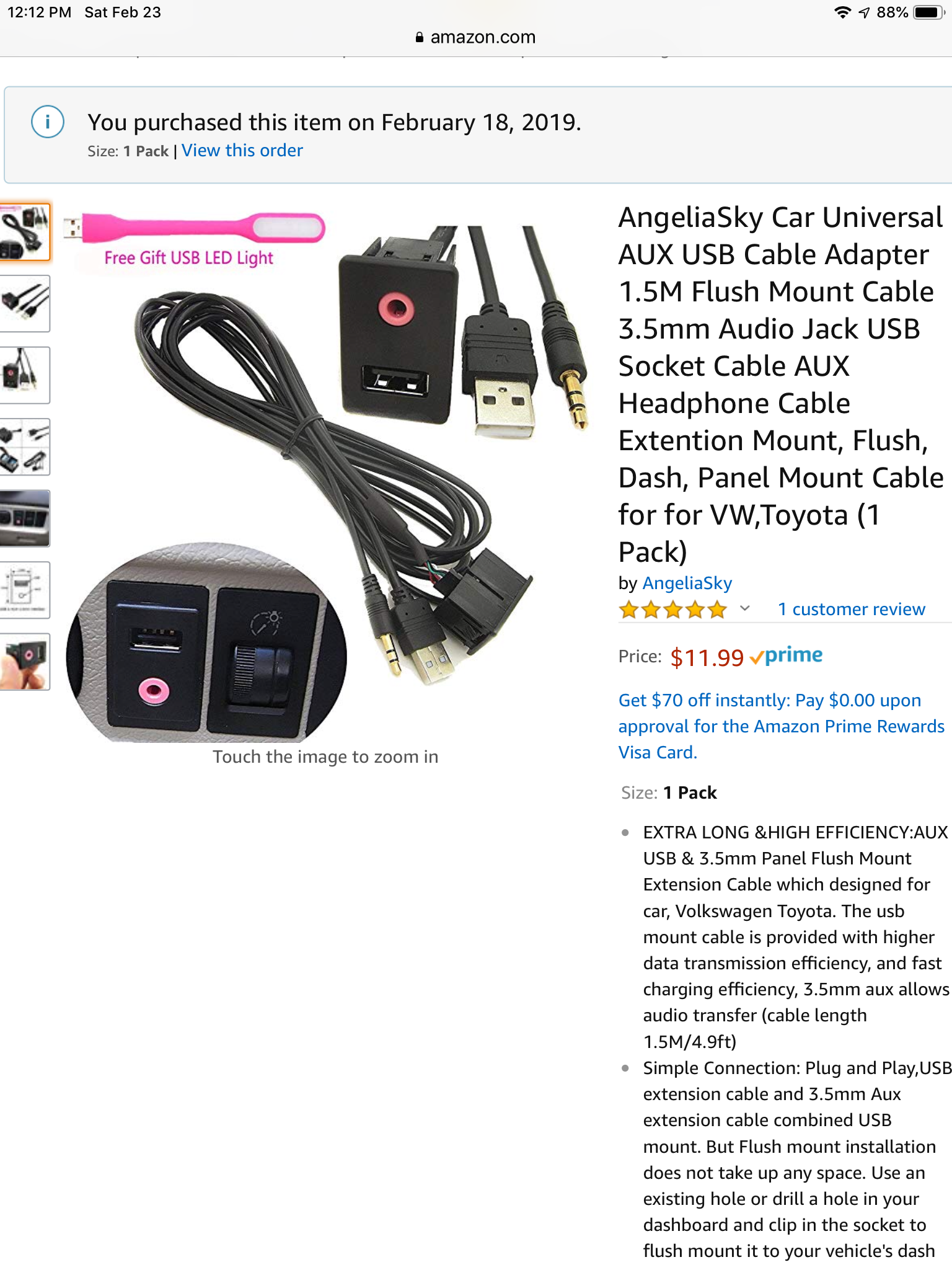

  1. I just installed a Pioneer AVH-2440NEX, Metra 99-9604b dash kit and Scosche LPPE15 wiring interface from Crutchfield in my 2005 Cayenne. Absolutely terrific sound. Existing amplifier and subwoofer work great. I highly recommend using their $25 ReadyHarness Service tp pre-wire everything. Like others in this forum, I needed to trim the dash plate to get a nice flush mount. The USB AUX adapter from Amazon fits perfectly in an unused dash hole. Total installation was was less than $700. $350 for the radio and about the same for the harnesses. The Axxess ASWC-1 steering wheel control adapter is not needed. A 3.5m plug on the adapter fits in the back of the radio and gives steering wheel volume and track control.
