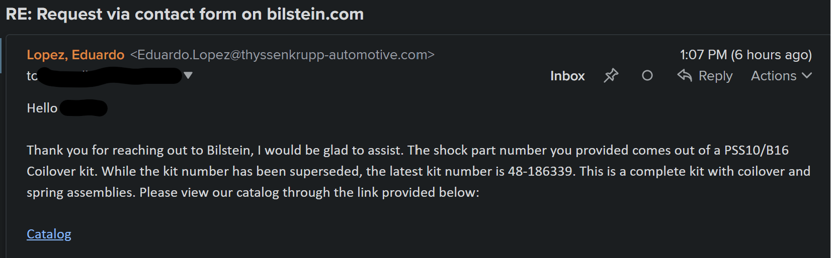

  1. I know this is an ancient(!) topic, but this thread came up when I was looking for info on my inherited suspension setup. My right rear shock has the model number F4-BM5-D540-H1 on it. I reached out to Bilstein support. They confirmed the model number I sent is an old number, but from the PSS10 / B16 coilover kit. When you look up the kit number provided by Bilstein, it shows that it is appropriate for a 996. Thought this could help someone else who lands on this page looking for similar info. -Kip
