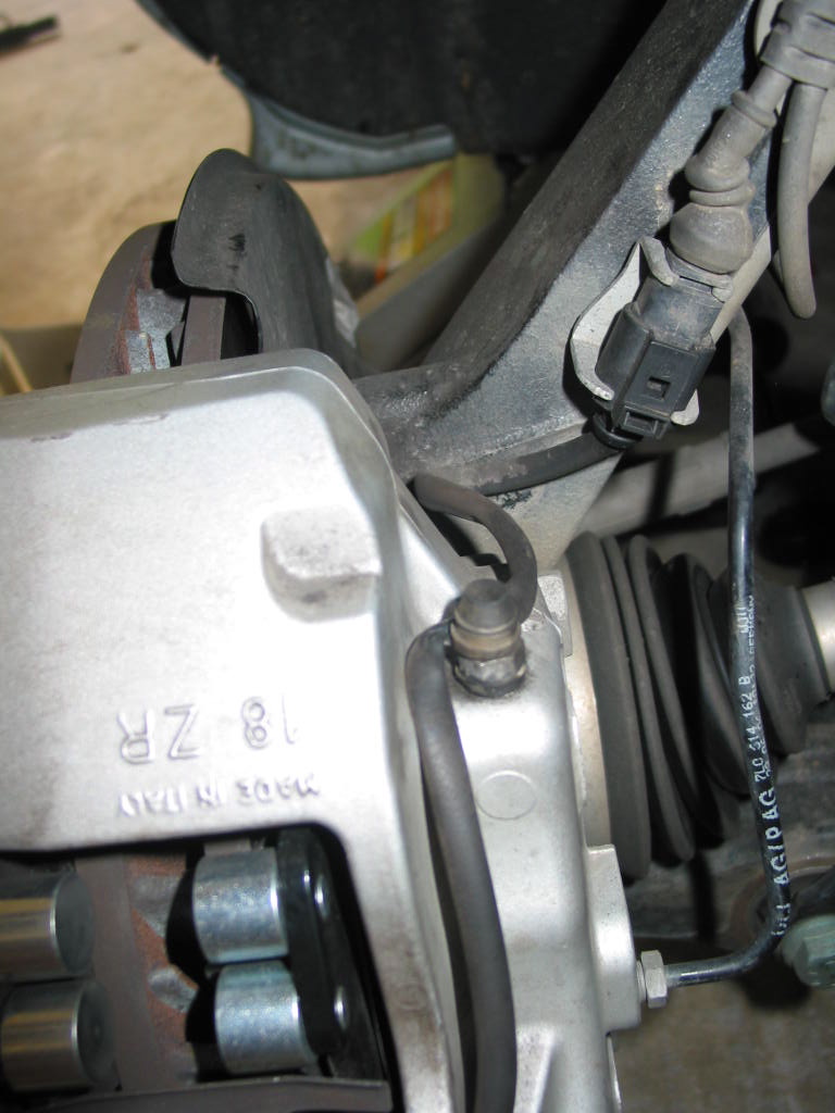

  8. I completed the brake fluid flush with ATE Typ 200 and a Motive power bleeder. It was a little difficult to keep an eye on the fluid level in the reservoir due to the gold color and the hidden nature of the reservoir, but the procedure was very straight forward. I could have done the entire job with one liter, but I wanted to be extra thorough with all the bubbles and debris flying out of the nipples, so I ended up using 1.25L. Interestingly, "ATE" is molded into the brake fluid reservoir. The only point of interest, sort of, is that the factory routes the brake pad sensor wires through the rubber covers for the bleed nipples as shown below.
