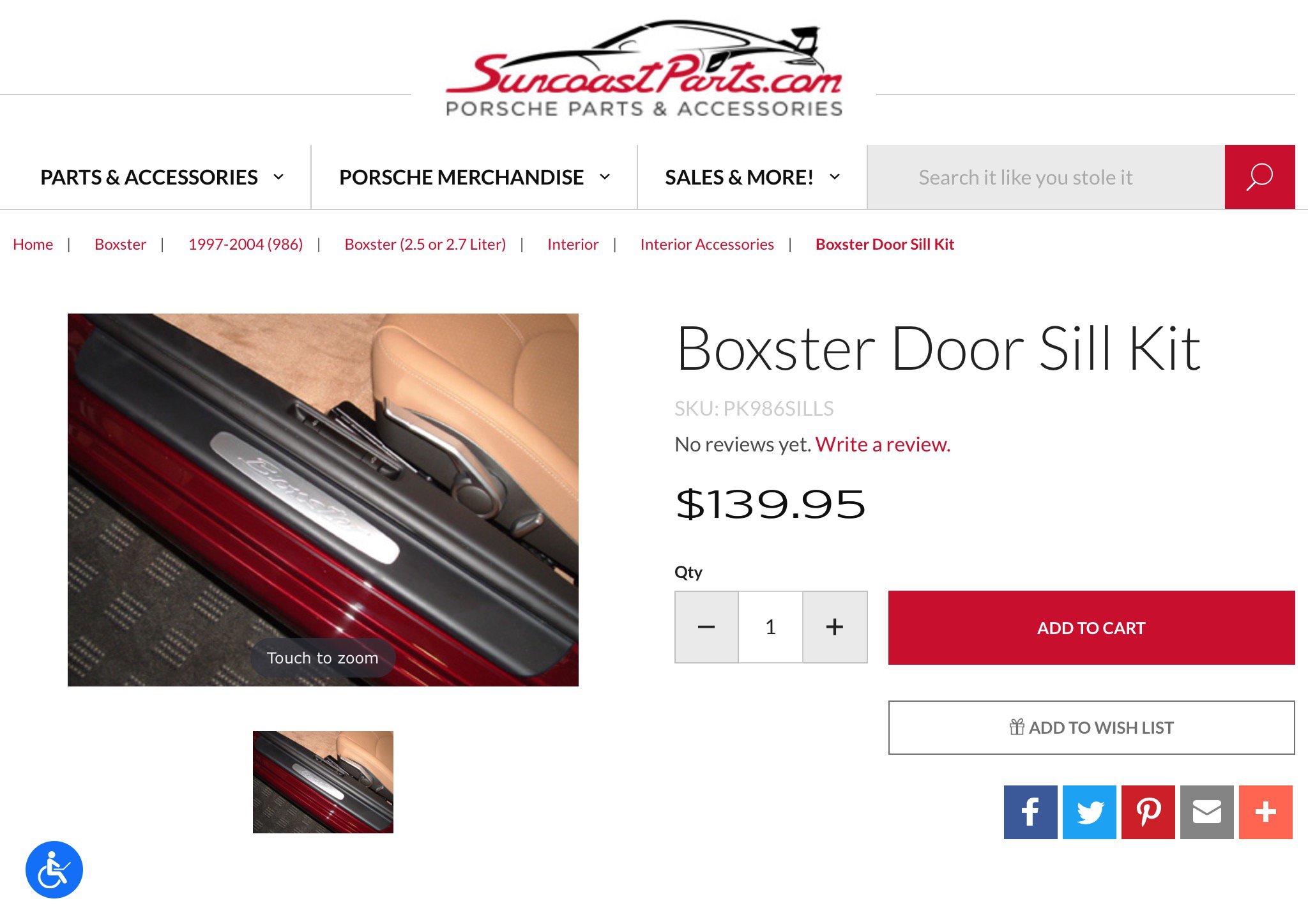

  2. Hi does anyone know where you can buy these from as from what I can see these guys do not deliver to the UK They state they are for the 986 and the photo is just a guide.
