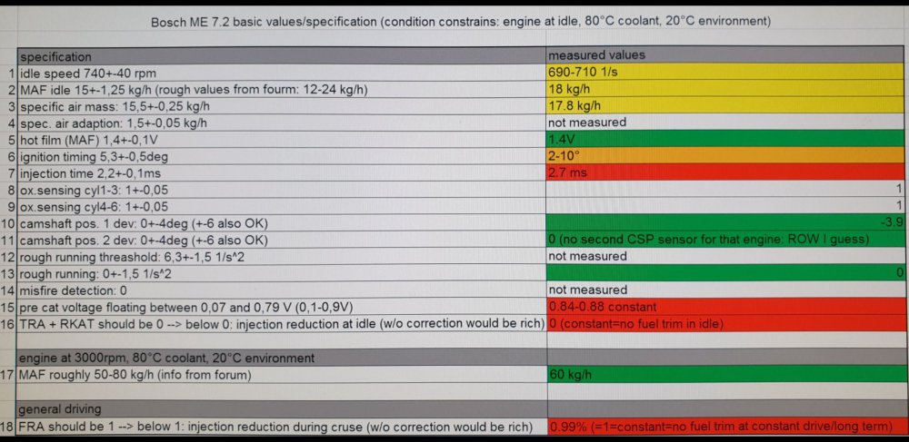

  1. Hi, no, It's still not in closed loop. I just adjusted the maf voltage by hand until the external wide band o2 sensor showed adr 14.7 in idle. That's it. The narrow band o2 sensors from the ecu also reacted during hand adjustments. (jumped from rich to lean when i was near 14.7 as they should). but everything in open loop, no automatic fuel adjustments. --> currently it looks like he really needs that ammount of air and gas at correct afr to maintain 700rpm idle ?
  2. My durametric (old one) has no button for ecu reset, just for failure code delete. I will check O2 and fuele trim values after disconnecting/reconnecting the batterie. What I did today: Soldered a potentiometer into maf signal line to manipulate the voltage to get 14.7 afr in open loop. What to say...O2 sensors (wide band external and regulating sensors) reacted immediately. Adjusted to afr 14.7 (was just a very minor amount of adjustment) and got 700rpm 2.7ms injection (accurate measurement) Afr ~14.7 (accurate measurement) 18kg/h maf (hand adjusted via potentiometer) 2.4% engine load 2% throttle (accurate measurement) This looks like I have an increased amount of mechanical load at the engine or maybe a compression or timing issue (??!!) What I'll do tomorrow is trying to get rid of the sai failure code and reinstalling sai pump relais (maybe this is preventing closed loop mode) MAF: guess it is giving reasonable values, even if they might be a bit off intake temp: confirmed with reasonable values via durametric coolant temp: confirmed with reasonable values via durametric, CPS: new sensor installed, no codes any more (still suspicious due to aasco flywheel) cam sensors: just one in row engine but this gives me 3-4deg. offsett: Should be ok O2 sensor heater: sensor are perfectly responding on maf modication and coast mode. Bad heater should also throw failure code O2 sensor: similar too heating knock sensors: that's something good I wanted to check but don't know really how to. Will upload a engine running video for you

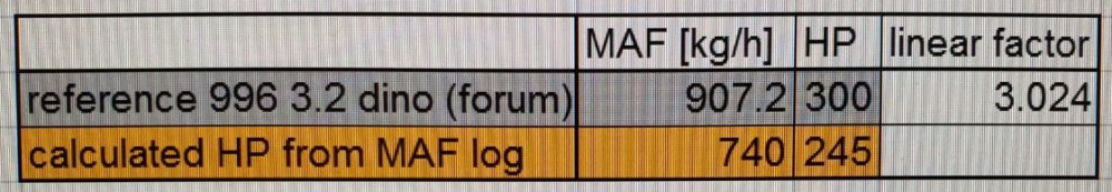

  4. summarized idle values and a MAF plausibility calc. that I did some days ago based on any 996 3.4 porsche dyno log I found in the web (for sure don't know the accuracy)

  6. Anyone has any advise? Don't know what to do else: Ecu is not adapting fuel trims and retards timing over 4k rpm

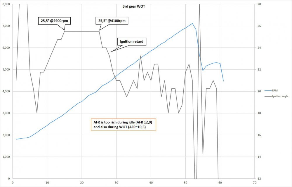

  7. made a 3rd gear wot yesterday with a wide band O2 sensor on board. Idle is running at afr 12.9, wot at 10.5. Ignition angle is retarded at 4100 rpm ? I guess there is an additional major issue.

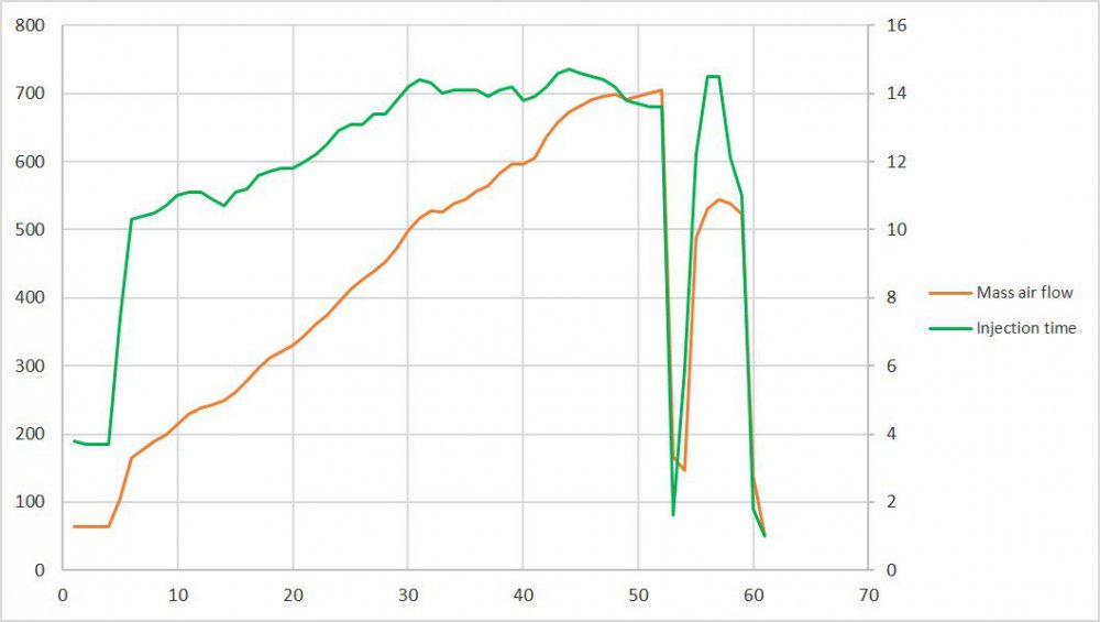

  11. I just ordered two post cat o2 sensors to complete the system again. Aditional comment: I disconnected the complete secondary air system including electric valve. Might be an issue? picture shows idle and 3000rpm. MAF values makes sense, O2 voltage goes down when engine costing down. Injection graph is normal?
