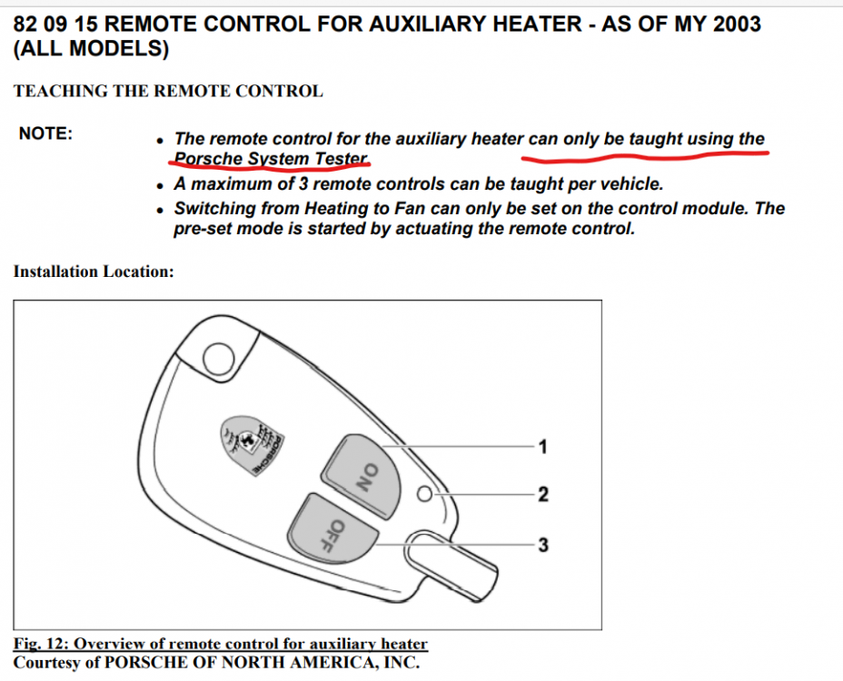

  4. Hi, old thread, but I was trouble shooting my heater, it goes on and off and has a life of its own. During Piwis work I came across this menu, where you can program the remote. See picture.
  5. Hi, old thread, but I was trouble shooting my heater, it goes on and off and has a life of its own. During Piwis work I came across this menu, where you can program the remote. See picture.
