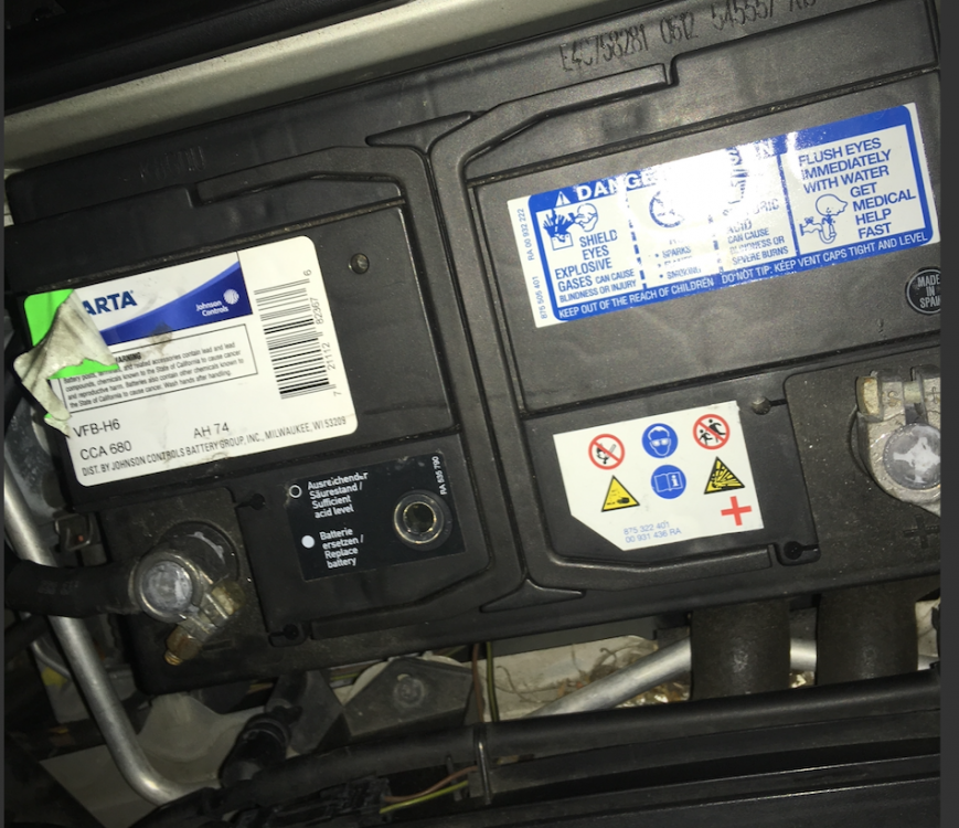

  2. Temperature and gas gauges are both working. In terms of the instrument cluster, everything appears to be in working order EXCEPT: analog speedometer= gauge does not move digital speedometer= blank/LCD does not turn on, however the backlight works tachometer= gauge does not move odometer= blank/digital LCD does not turn on, however the backlight works digital clock/oil level= blank/digital LCD does not turn on, however the backlight works tiptronic lights are in limp/safe mode (blinking lights alternating between D and 4) tiptronic light is on D when car is parked and turned off, but headlights still on On second look at the battery, it is a Varta H-6. Found it online here: https://worldimpex.com/part/battery/2320H6VAR/ and at pelican parts: https://www.pelicanparts.com/More_Info/H6VAR.htm?pn=H6-VAR-INT Retails a lot less than the $354 they quoted me... also, they quoted me with an H-7 battery and put an H-6 in there. Don't know what that means but it is suspect. Maybe they would've put the battery I was quoted on in there if I signed off on it initially but something tells me that was the battery they would have always put into it. Even more ridiculous is that they told me that I can buy and put my own new battery in there and give theirs back to them OR pay them the quoted price. As far as manufacturing date I haven't been able to find it, though there is a green sticker with 11/18 on it? I'll attach a pic of the battery if you want to take a closer look. And thank you for the advice, I'll add the gear selector switch and plug to the list of things to look into!
  3. Yea, I feel like a conspiracy nut telling this story but it all just seems way too shady to me. I wanted to throw as much info as I could out there in the long post to get the full picture of the situation. I forgot to mention that after I left with the car, I decided to inspect the battery myself. Well as it happens, to get to the battery you have to pop the hood with the hood release latch, which was of course stuck. I was already aware of the common issue with the locking cam getting stuck and that it can be moved with a thin flathead screwdriver to free up the latches before I dropped the car off. I had been intending on doing it but life and then the transmission issue happened and it slipped to the wayside. So I never got around to it, and threw it out there when I dropped the car off since I figured they've seen it a million times and would get it done in a jiffy. Instead, they had told me that it was broken and had to be replaced. Luckily, I declined that because the second I got home, before I even went inside to grab the skinniest screwdriver I owned, I decided to just put my foot down on the floorboard and gave it a good hard yank. Voila, fixed. Greased up the insides of the mechanism and haven't had an issue since. Saved myself from the $900+ job they said was necessary. When it comes to the transmission, I haven't come across any info that says it can be an issue with the transmission wiring harness and plug or sensors on the valve body so I will definitely look into those, thank you! As far as the A/C, it had worked fine up until then, and something tells me its an electrical issue but I will go ahead and check the ac system pressure. Radiators do not turn on when AC is on with snowflake light on (no worries and no offense taken, thorough is much appreciated). I will also take off the bumper and clean out the radiators to see if there is an obstruction issue/leaks there. Coolant was topped off after noticing the leak, and current level is stable, however when car heats up the level rises to the max. Honest mechanic I mention in the post above says that the excess, if there, dumps itself (I guess something all cars do?). Battery charges fine/holds its charge/alternator fine according to durametric however the fact that the voltage was low after sitting for a couple days worries me that something staying on after turning it off and is draining the battery when the car should be off. I also just realized that the recommended battery size for the 1998 986 is H6, however they put in an H7. Would that have any negative effect? The reason why I think that it is all related is that all the symptoms happened in the immediate aftermath. After hours of sleuthing around various forums and threads, I've noticed a lot of the symptoms are connected in various ways, but haven't come across anything that pins them all together. In terms of the cluster issue, the same exact occurrences have happened to others, but in those cases it seemed a bad fuse, loose connector pins, or ignition switch replacement seemed to do the job. No cigar for me however. I will look into the transmission recommendations you made as they are a new angle that I haven't yet explored. Hope it works! Thanks a lot!
