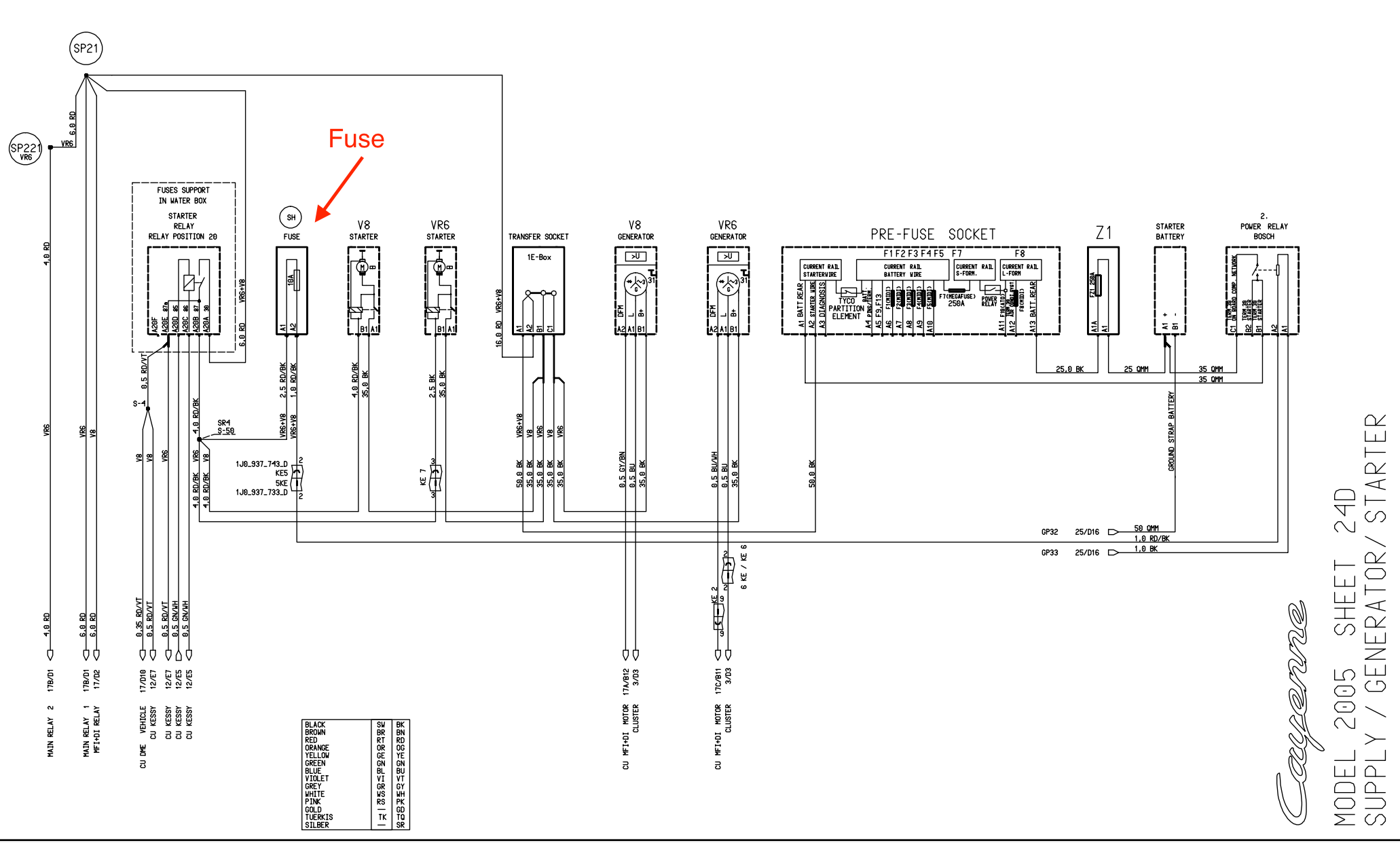

  3. Last week I got in the car to start it and there was power to everything and battery volts fine, but no action from starter motor at all. It worked perfectly up until the moment it didn't work at all - which was 30 minutes after parking the car. Before I pull everything apart to check the actual starter I am trying to eliminate other possibilities, the wiring diagram attached shows a 10A fuse in the starter circuit but I cant find its location. I have already tried jumpering the relays. Any ideas?

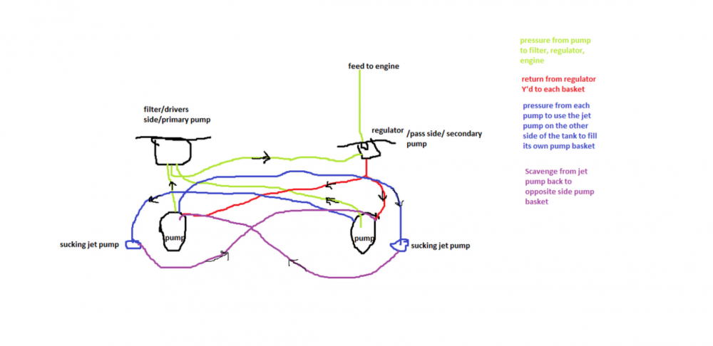

  6. No need to apologise, I already had the drawing and another image - I just assumed like all the other connectors that it was impossible to connect incorrectly, so I had never checked or even considered that I had done something wrong and was blissfully unaware that they sucking jet pumps went to the opposite side fuel pump. I am just very grateful you replied a couple of times and gently pushed me in the right direction!
  7. Thanks Loren, its somewhat confusing about Pump 1 and Pump 2. I have seen different 'official' quotes of which runs when and why. Some places quote 25lt or ¼ tank as the switchover to the other pump. No doubt mine cuts out at exactly 25lt. Its further confusing because Porsche just label the pumps 1 & 2 whereas many talk about them as primary and secondary. After thinking about what you quoted I thought, if thats correct I am following a red herring by jumpering the relays, I need to go back to where the whole problem first raised its head, which was after changing out the pumps. So I decided to pull the covers off and remove the pumps, starting with the left hand side, I got the pump out and then thought the other thing I have never got my head around is what and where the sucking jet pumps that people refer to are located. The left hand side of the tank had very little fuel in and when i felt around I realised the sucking jet pumps are way forward, under the front seat and in fact the tank is shallower in that section so the left hand side sucking jet pump was high and dry! I went back to all my notes and pictures and found a really good hand drawn diagram from another thread that clearly shows the left side sucking jet pump is plumbed to the right hand fuel pump and vice versa. These connections are the only ones that are interchangeable and when I put the new pumps in, somehow I missed this vital piece of info and had plumbed the left hand sucking jet pump to the left hand pump and vice versa! When I pulled the cover off the right hand pump the reasons for my problems were obvious - the tank looked to be ⅓ to ½ full - the incorrect plumbing had caused the fuel to be pumped across to the right hand side of the tank! So I plumbed it all correctly and then got the car running and it ran happily with well under ¼ tank without any jumpering etc. Thanks Loren for persisting with me, it definitely got me on the right track!| For anyone else having the problem of the car cutting out at ¼ tank of fuel this is worth checking, its not such a difficult mistake to make! (thats my claim anyway!) I have attached the image that helped me understand how it works in case anyone else finds this thread. The only thing that still seems a little odd, but I haven't bothered trouble shooting yet, is I still dont hear the pump running when i open the drivers door anymore.
