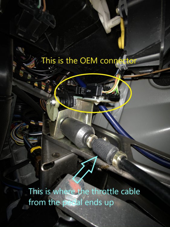

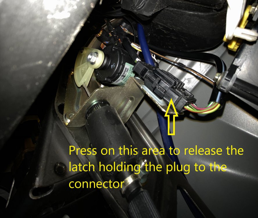

  4. The shop has the Durametric and a Porsche Gold Meister technician on staff, so I’m confident they’ve tried to simply reset it. The most likely culprit is gunked up inlets on the cylinder heads causing a restricted airflow, or that’s what they tell me. The car has just reached 100k miles and it is not uncommon for them to get this way apparently. It’s 15-16 hours of labor to disassemble & clean everything, hence the cost. Since I plan to sell it soon I’m leaning towards biting the bullet and making sure the next owner gets a clean engine. We’ll probably do gaskets and other stuff while we’re in there too. I’m hoping someone on this forum has managed to clean these inlet ports without having to disassemble everything and is willing to share the method, but I know it’s a long shot...
