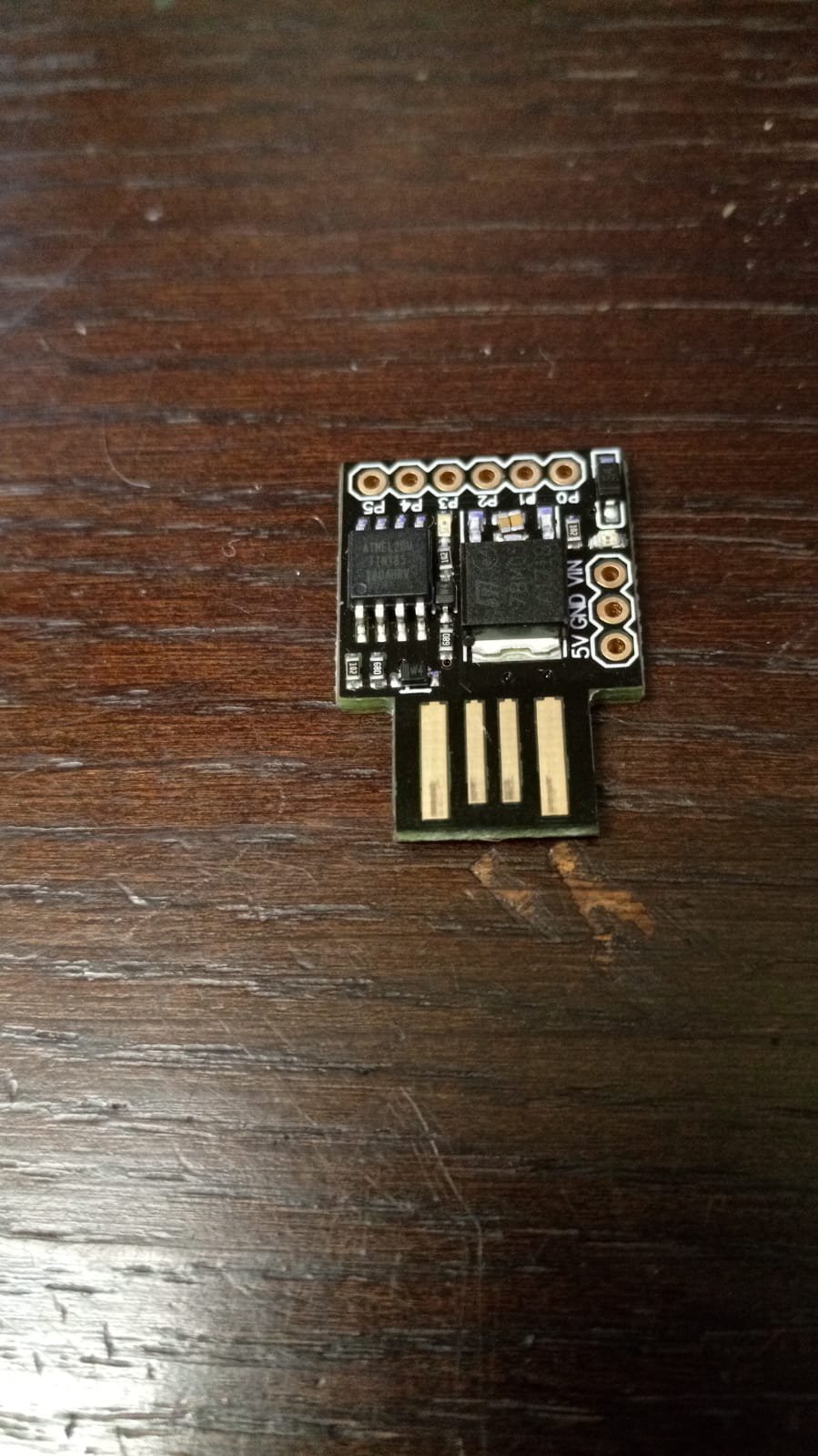

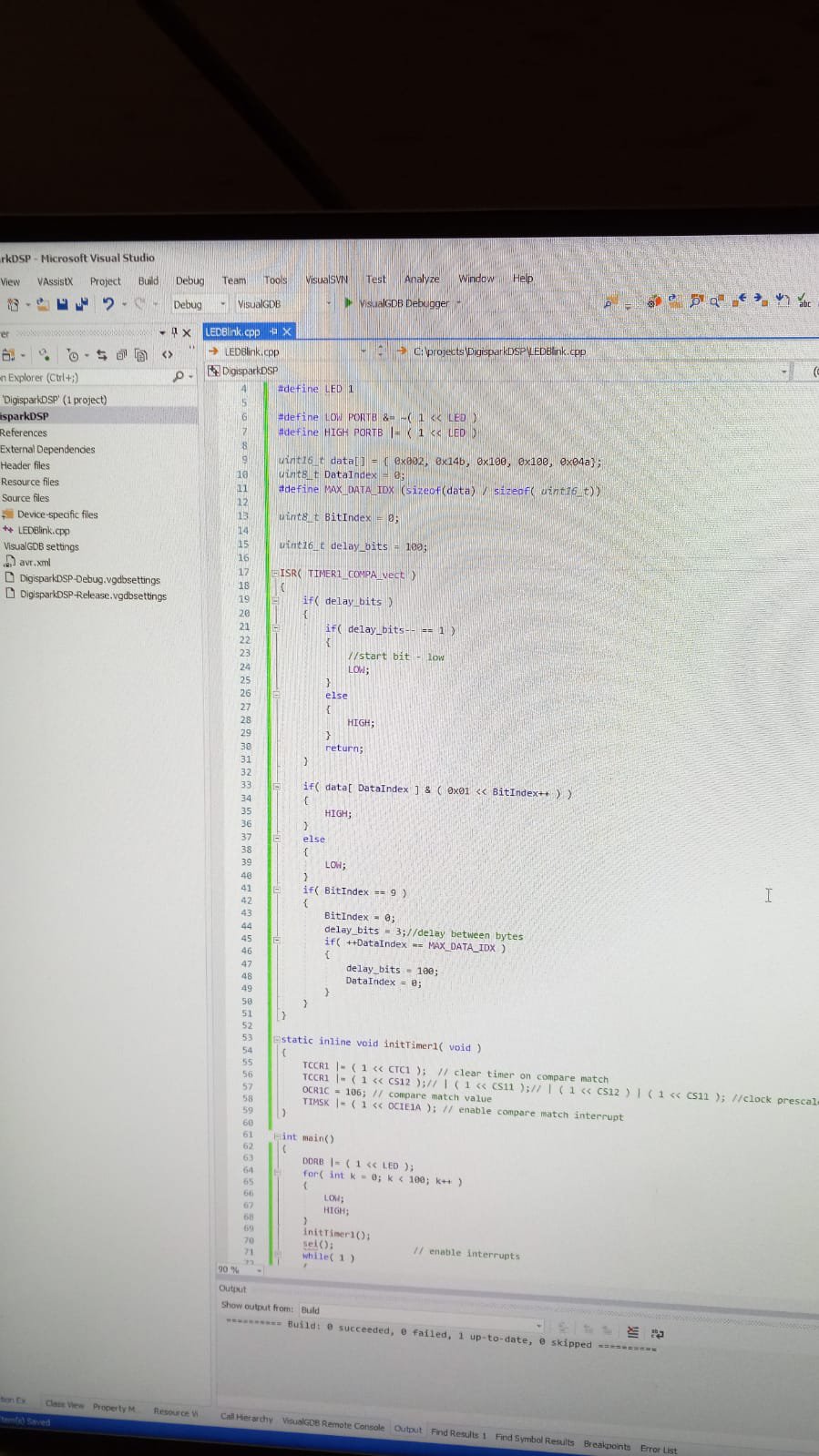

  1. Hi. Maybe it is useful for someone like me. I swapped headunit on 996 with PCM1, DSP and M680 (nokia) amplifier. Then i found out amplifier does not work without proper signal from headunit. I made simple hardware that tells amplifier to turn on max volume. That allows to use aftermarket headunit with line out. For hardware i used attiny85 board - digispark ( probably chinese clone as there are no proper markings on board ). It is 5V microcontroller. Amplifier expects 5v serial signal ( 9bits + 1stop bit 19200baud rate ) Full code - https://pastebin.com/N3PG4Rqe Hex firmware for attiny85 attached. Can be done with different mcu. Bytes to send are visible in source. DigisparkDSP.hex
