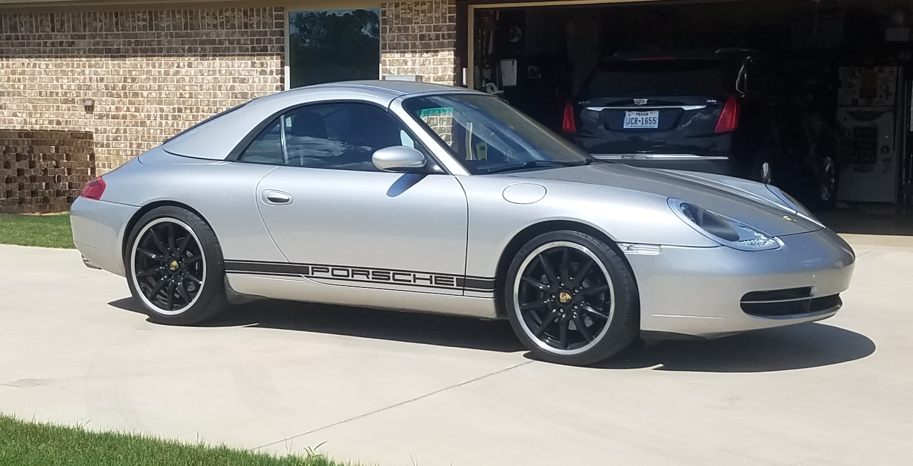

  2. No fuel pressure in the engine compartment as I get no fuel pump run. One question I have, is the fuel pressure regulator controlled by the FRC that some have mentioned located on the relay tray in the rear and if so does it also control power to the fuel relay under the dash? If it switch issue can you replace just the mechanical switch or do I have to have the key reader, ECM and Immobilizer?
