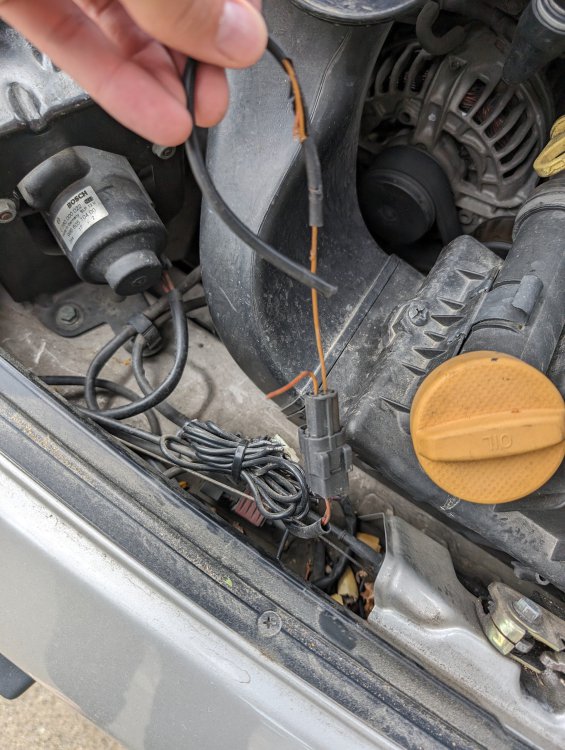

  1. Hi folks, I've been dealing with an incredibly frustrating mouse problem for a while, and today I noticed that they'd been at it again and chewed through a wire in my engine compartment. The car runs fine however and no warning lights are on, so I'm wondering which wire the mice cut this time? It's a brown pair, it has a plug that looks like a sensor plug (see photo, apologies for the dirty car), and I have no idea where the other end of it goes. The previous owner installed a backup camera so I have some extra wiring back there, but this one looks like it came from the factory. Does anyone know where this wire goes? Cheers, Tobias
