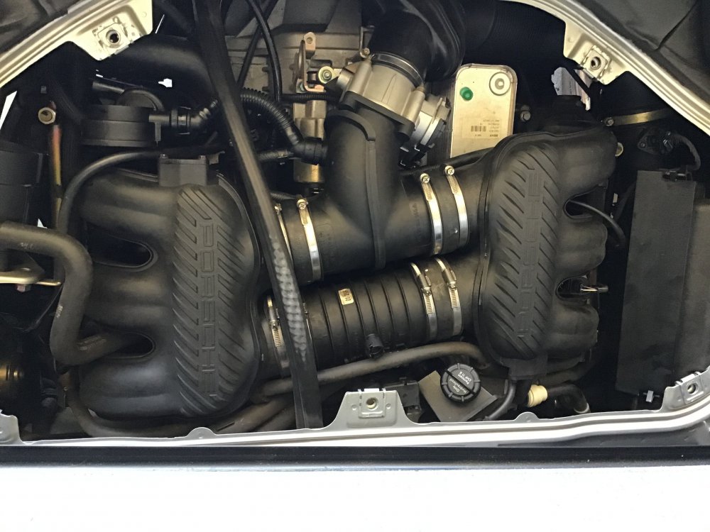

  2. OK, I can answer my own question, the vac take off goes to in the throttle body T tube, top left in the photo in the previous post. I will need to check mine is in the right place.
  3. I wonder if you can help me determine the location of the vacuum lines in the rubber connectors on the intake tubes? In the attached image above, the front tube (flapper?) has a butterfly valve controlled by vacuum and then in the rubber connecting tube (right hand side in this photo) there is a vacuum take off. The rubber connecting tube on the left hand side also has a vacuum take off (see photo below), should this be on the tube connected to the throttle body (rear) or on the tube at the front? I think it should be on the tube connected to the throttle body, but I can't find an image anywhere to confirm. I think that the vacuum take off at the bottom of the picture (above) might be on the flapper tube and not the throttle body tube. I am not sure how much difference this would make? Hopefully someone can set me straight.

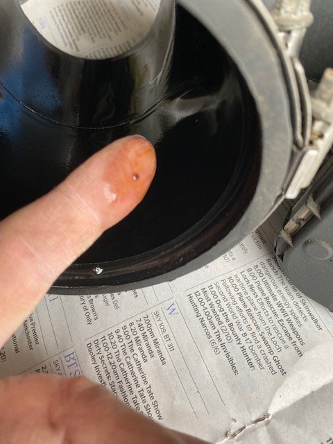

  5. I took the throttle body off, there was some black deposits around the opening (see photo), but overall it was fairly clean. There was a small amount of [clean] oil in the black plastic tube after the throttle body and small amounts in the plenum and second plastic tube with the valve in it (see photo). The oil wasn't excessive and I changed the AOS last year, then there was a lot of oil residue in there. A short test run and it is may be slightly better, but still a little rough at low revs/throttle openings. I don't get any fault codes and don't have a misfire (since charging the battery) so I now suspect coils or plugs. Coils were changed in 2008 at 52k miles, plugs I can't find when they were last done, I am sure they have been changed, but can't find a record. I can't find the exact service interval for plugs, I see it quoted as 24k or 40k miles, so think I will have a look next chance I get.
