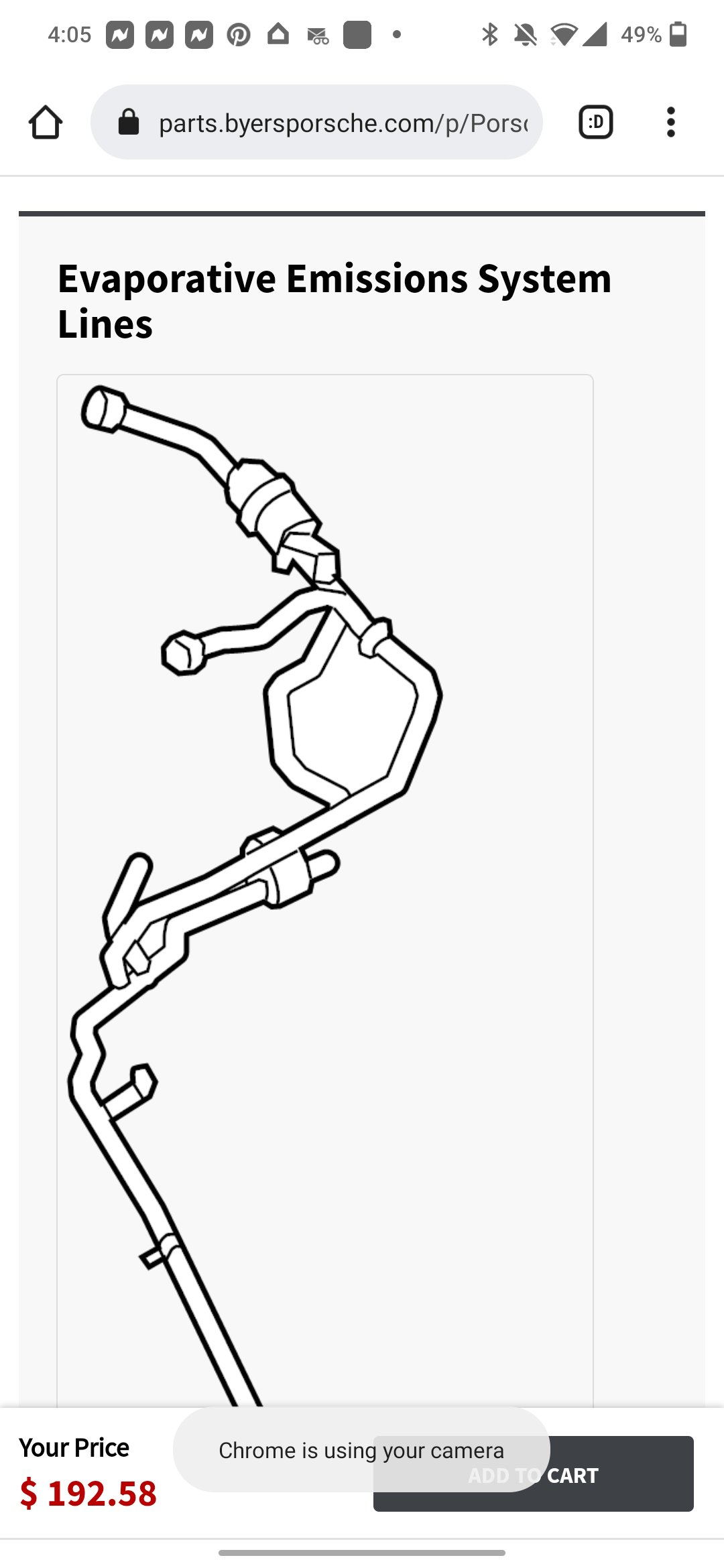

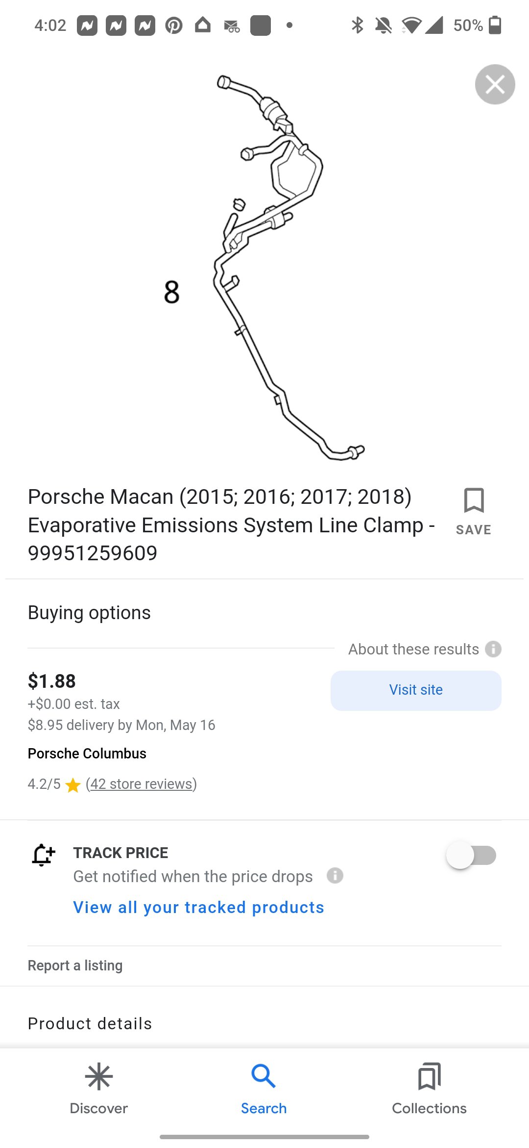

  2. No. But I think it is air suspension compressor air filter. And it seems like for this car their purge valve is the crankcase check valve. Or am I looking for the wrong part? When I tried looking for purge valve for my car the 2 breather valve would show up
  3. Is it suppose to be disconnected like that? Do you know the part number by any chance
  4. It is on top of tire behind headlight. Took off the covering. Not sure if that hose goes with that and if it does then should there be a adapter to go into that valve or canister thing?
