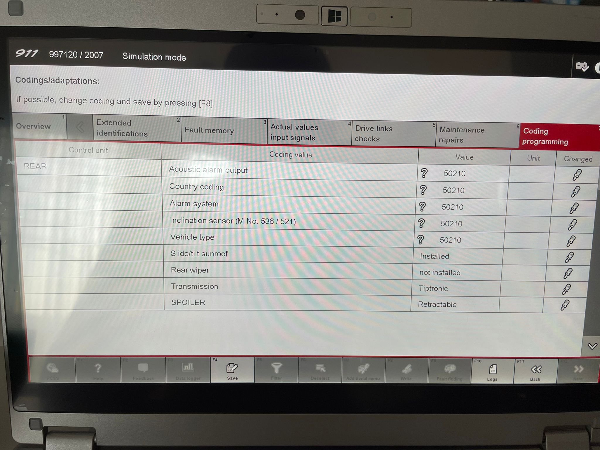

  6. Thanks. I will try to get them. today I found another strange thing. I was playing around with my PIWIS in simulation mode. the same ‘corrupt’ fields appear and i am still unable to change the fields in simulation mode.
  7. I already tried to recode it using PIWIS. It didn’t change anything. I’ve never heard of these IPAS codes. Can you explain further please?
