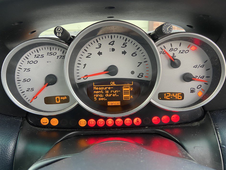

  1. Hi Guys, I have recently had an airbag problem with my 2003 Boxster S 986. The airbag light did not cancel after using meter to correct. So after running a diagnostic check on meter it told me that the problem is coming form the airbag in steering wheel. After watching a few videos on youtube I found that it was probably the clock spring in the wheel so I got a second hand replacement clock spring and fitted it. Form that point on I noticed that when I started the car that not all the warning lights came on. The lights that don't come on are the third and fourth from the left. The third light is a triangle with an exclamation mark in middle which I believe is a PSM light and the fourth is a PSM OFF light . Also the very far right light which is for the ROOF also does not come on. The Air bag light does come on but goes off very quickly. Also I get a double beep if I open either of the doors. I'm thinking the new clock spring may be faulty, does any one agree
