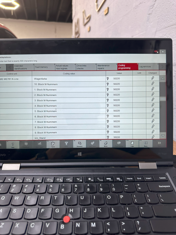

  3. Trying to reactivate Sports Chrono mode (I do have the activation code). However im getting a negative control unit response error which to my understanding means that the sports chrono feature is misprogrammed in different modules (just my hunch). I was digging around in developer mode to see if I found anything and I have these checkmarks mostly in the ECU programming. Not sure what goes here if anyone has any rough idea

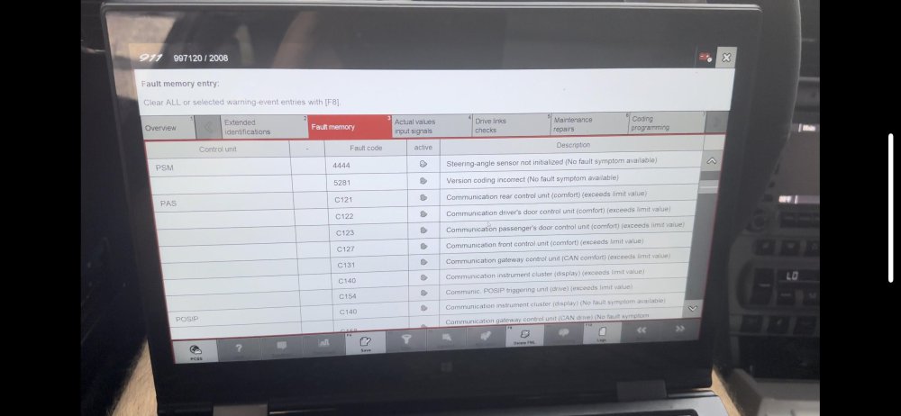

  5. IPAS: Asked around and they couldnt give it to me so making sure i have nothing else to do before i take car in to my indy. however i ran a PRE VAL and am getting this error in my gateway which im assuming is the culprit. “50210: Coding value cannot be determined”. However in normal mode i cant see a way to code the car in basic coding so not sure if developer mode has something since i cant find anything online

  7. It appears that in the DME programming the values for vehicle version and type were empty however when trying to set them in i get this prompt. Not sure what version to select. And on top of that the next screen is asking for old and new immobilizer codes so i didnt proceed since thats out of my scope
  8. I just attempted to do a Handover and PAS had an error next to it. Something is coded wrong in the gateway or the dme
